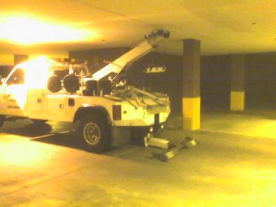

here's a pic of me parking in a towaway lot making sure that whoever was going to tow me was going to get a workout:D;p

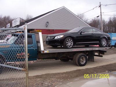

heres a pic of mine with over $100,000.00 worth of mercedes i repoed

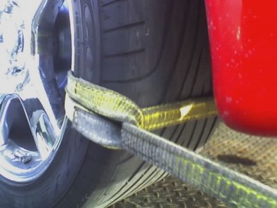

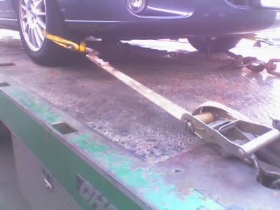

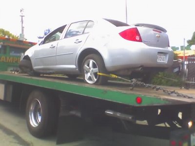

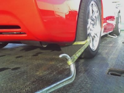

hey rich-
if you bagging stuff for daimler-chrysler credit or their new entity, get yourself a set of these straps. they run from $11-15 and is very well recieved by all high end customers. not to mention, it's easier than hunting for T-hook slots.;Sweet
i can send you the design data if you have a local guy who can make them.

you can make them yourself i did!!it was easy,**** why buy things if you can do it yourself!! i fabed my own reciver hitches with c chanel and all thread!! as well as a motor cycle carrier for the wheel lift!! its easy, a welder, torch,hammer,steel and beer you can do anything!!
true.
but when you're dealing with high dollar stuff, the ANSI tag is worth it's weight in gold if a liability situation arises. the shop charges me an extra dollar to sew in the tag and I gladly pay for it.cookoo
