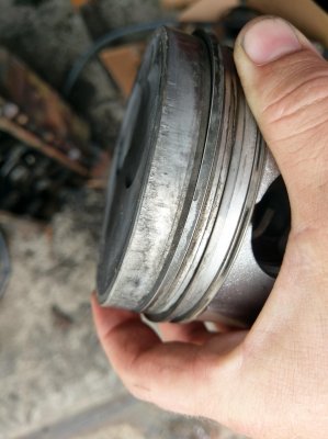

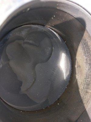

He's definitely going to balance the engine he says. He got the heads off today, he says the pistons look fine, i forgot to get more pictures of it the carbon ring where he scraped it off, its just a ring he says its not worn in at all, or a ridge, or some technical term i forget. The cylinders looked like maybe they had some rust or something on them or maybe it's normal? The truck has sat a few months but i did get it running and brought it up to temp weekly for the past couple months. He didnt seem to concerned about it, he thinks it can probably just be honed and reuse the pistons.
We're havin' fun now! I'm going .020 over on mine. Cylinders were pretty worn from running on dusty Montana prairies with a poorly fitting air filter, so my machinist was able to just hone it to size. Found a guy with a machine to balance mine as well, normally only does work for the semi repair shops, but I talked$$ him in to it. Here's hoping we both turn out OK!
I'm sure he will, but ask if he plans on measuring bore taper. I bet it's out of spec. IMO, always a good idea to get cylinders bored to "true" them up nicely. Especially on an old worn out Idi. Some say that .020 over on a 7.3 & .030 over on a 6.9 is safe to do.
These engines have a very high compression ratio. Any taper in cylinders will cause engine blowby & power loss.

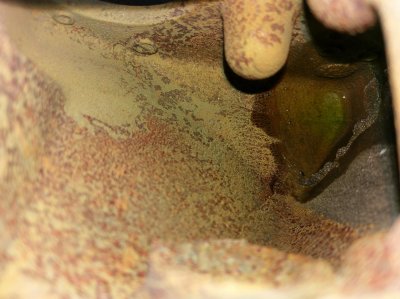

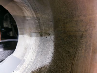

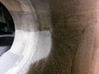

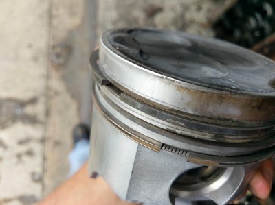

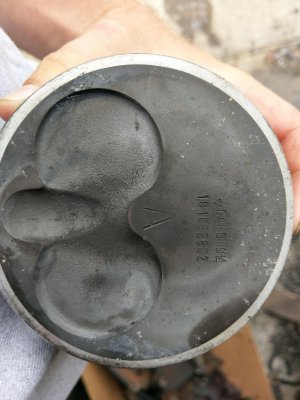

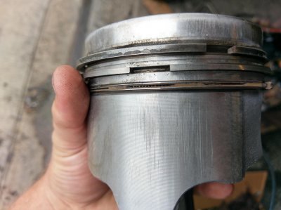

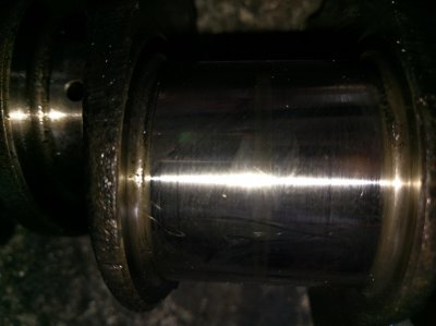

Here are some pics i got when i was there today dropping off the new clutch and flywheel to be balanced, a couple scuffs on the pistons, a scratch on the cylinder wall, he wasnt too worried about either of them, he said the crank journal looked good. I put a borescope in the coolant ports, the cylinder surfaces looked good, on cylinder 6 i found possible oygen pitting starting but it was just at the surface, could also be flash rusting in just that area. The block hasnt been washed yet or anything.

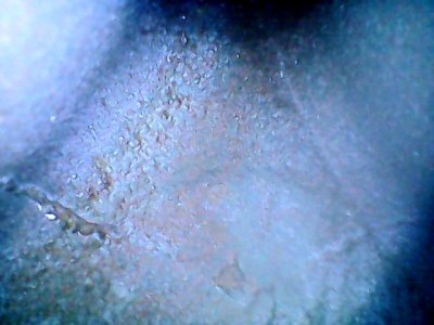

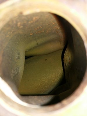

Some coolant surface internal pics

I dunno...bores look nasty to me...but wait for better pics
Crank has some scoring going on minor...how do bearings look?
Pistons scuff looks eww..but crown looks saweet.
Again reserving thoughts till bores are cleaned and same with the rest.....
