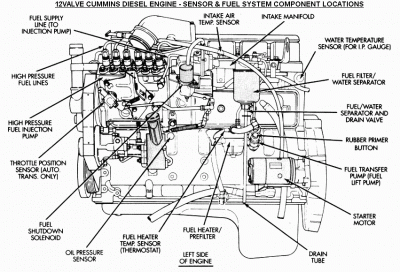

Hello I am now the proud owner of a 1996 Dodge Ram 3500 Ext-Cab dually with 53000 miles and would like to know where the fuel water seperator is on the 5.9 Cummings in this vehicle. Any help will be appreiciated for this is my first diesel.

Here ya go. Here is the engine mounted one. :)
If there's an after market filter such as a racor, etc,
you're on your own as to where it's located on the truck.

Thanks rubber fish but what is the big hose hanging down in the middle of the engine compartment, sticking out past the oil pan???

I'm confused. Are we talking on your truck? Or in this pic?
On your truck, I'm guessing it's the breather tube you see
hanging down. Kind of as big as a heater hose? That one?

I am kinda talking about both because there is a hose about that size hanging down on that side of the engine about where the hose in the picture is. But if it is a breather hose, what is that for??? I really apologize for I know just about jack squat about diesel other than they are great for pulling and still getting decent mileage when pulling. :)
