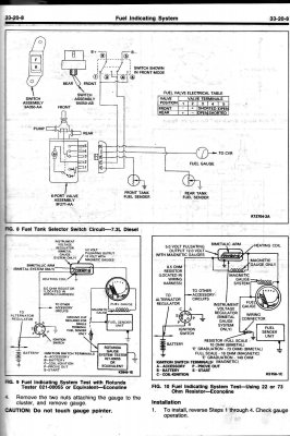

Here are the pics for D_A_V

Thanks for this.. I was trying to locate a good diagram myself, now i know why my fuel gauge is not working.. Seems i'll need to put the selector valve back on it and plug it in to complete the circut, i switched to a single tank so i just deleted the selector valve..
