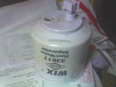

welcome;Sweet
go down to your local parts house and order up one of these. no more bottom plate worries:D
