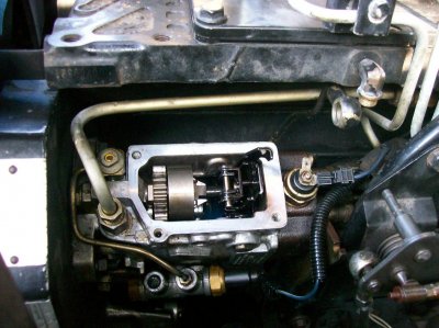

Here are a few pics for anyone that want to see what the Bosch pump looks like.

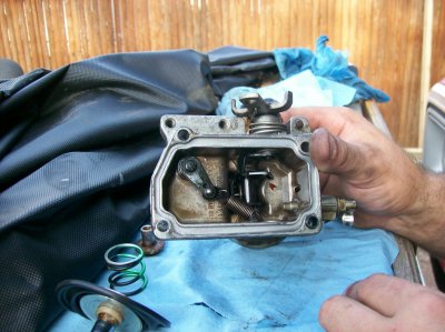

One word of advice, there is a pin, spring and washer combination (some call it top hat) that is connected to the governor shaft through the 3200 spring that You MUST not EVER loose. when You do this You'll see what I'm talking about. This thing has a life of its own and will try to fall inside the pump if You don't hold it well. It happened to Me and I was trying to get it out for almost 3 days. If You can't get it out You have to remove the pump and either shake it out of it or get to the bottom of it until You find it. Luckily I didn't have to do either, I blew air inside the pump until I made it come out.

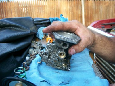

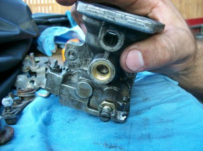

Here are a few pics of the pump and one of the pin I had so much trouble with.
