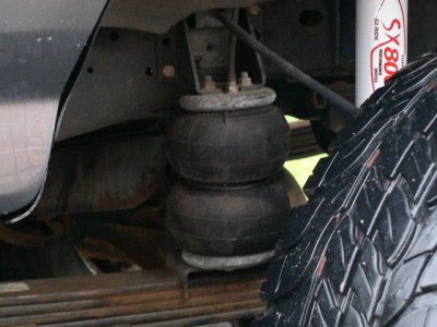

What kind of airbag thing are you talking about? Front bags on top of the springs? If so, I've got pics the set up I used if you'd like to see it.

I thought you were talking about front bags. I don't have rear bags yet. I'll snap some shots of the fronts tommorrow. wifey cleared the memory card a few days ago. -cuss. Bags on the front are great for plowing or heavy winch/bumper etc.... Mine are Firestone bags & seem to be tough as nails. I've had a little over 100 psi in each bag with no trouble. When I get around to the rear, Firestone will be my first choice.

Here's those pics. I paid 410.00 including the pump & in cab controller (lousy pic - There's a toggle on each side of the gauge. Up fills & down dumps the bags) from Michigan Spring Works. They ship anywhere. Rear bags should be about the same price. Good Luck

I thought this might be worth mentioning because I've heard it from a few people now. IMO, front bags wouldn't be such a great idea if your plan to load down the rear of the truck regularly (sp.). I tow a skid loader every so often & I dump the front bags completely to bring some weight back to the front end. I don't have a camper or anything like that, but the loader on a trailer puts the rear of the truck on the helper springs BIGTIME!! :eek:. I put those front bags on for two reasons: 1. I used to plow snow & my blade was extremely heavy which really pulled the front of the truck down & 2. I installed them when I had my stock springs in there to try to level the truck unloaded. It worked somewhat, but I had to put 90-100psi in the bags which resulted in a very bad ride. I since installed the 2" liftkit which leveled the truck like I wanted it & it would have been more trouble to remove the system that just leave it there. Just some food for thought. I would also like to install the rear bags, but there are other things the truck NEEDS (read Gearvendors :D )
