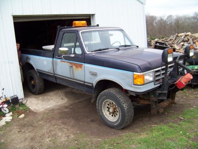

Hey Mel it's the black strip seen here on Droopy.
Getting that off there without bending it and curling it up is a real treat trying to keep it straight.
A heat gun usually helps in relaxing the tapes some as well too.
As said a good adhesive remover will do the trick at getting the residual glue off.
I don't know why Ford decided to put that stuff on a pickup.cookoo
