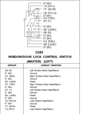

on my crew cab i have a switch to lock the rear windows but it also locks the passenger front window.my kid has a habit of playing with the rear windows.well its a PITA to lock them when i have his mother in the front seat as i have to put her window up/down for her.
what i want to do is make it so the switch only locks the rear windows.on the back of the drivers switch panel there is a pink with blue tracer wire going to the lock switch.no other wires comeing from it.

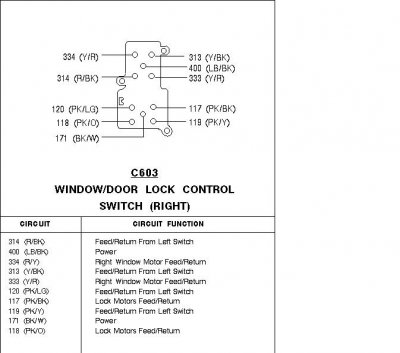

these are wiring diagrams from a 93 with power windows, hope it will help you some...
