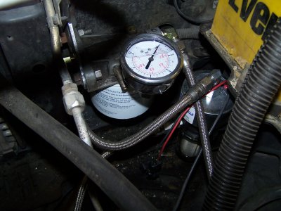

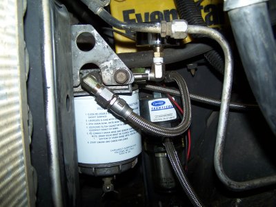

I installed mine the same day it came in the mail (thanks Gen Lightening!). I made a bracket that comes off the pass. side battery tray and the pump bolts there. That way when I clean the filter, I can unscrew the base while standing up - much cleaner than laying under the truck - and anything that drips falls straight down into a drip pan.

That's right where mine is, with the filter mounted to the radiator support. I'm bringing my camera today to take more pics of my progress, it's getting closer!
