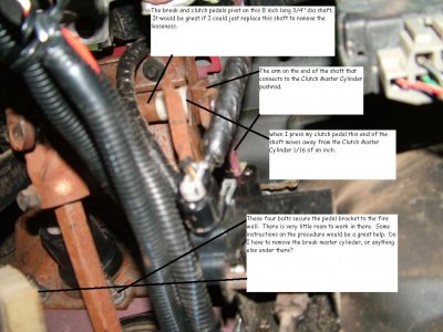

I have 1/16" loosness in my pedal assembly when I press the clutch in. The pedal assembly moves 1/32" or less, independent of the firewall, when I press the clutch. Is this enough to cause difficult shifting into 1st, 2nd and R? I have put a new clutch master cylinder bushing in and it did not help at all. I have no clutch reserve but I do have 7/16" travel in the clutch slave piston. Do I have to replace the entire pedal assembly? In such a tight spot, that looks difficult. Some instructions would be a real help.
See the attached photo. If you can't read the text zoom in or out on the picture.

I CAN MAKE THIS POST CLEARER...
I have 1/16" of play loosness in my pedal assembly when I press the clutch in. The pedal assembly moves 1/32" or less, independent of the firewall, when I press the clutch. Is this enough movement to cause difficult shifting into 1st, 2nd and R?
I have put a new clutch master cylinder BUSHING in and it did not help at all. I have no clutch reserve but I do have 7/16" travel in the clutch slave piston.
Am trying determine what needs my attention. When I back up sometimes the truck "hops" like the clutch may be a little warn. Could a warn clutch cause difficult shifting into 1st 2nd and R?
Some instructions on addressing the loosness in the pedal assembly would be a help.

The only known "real" cure...saved this from back when STD was "fun"...
Here are instructions for pedalbox bushing replacement:
1. Disconnect clutch master cylinder pushrod, wiring, 2-13mm nuts (outside firewall), and pull out into engine compartment.
2. Remove clip, bushings, and brakelight switch/wiring from brake pedal, pull pushrod away from pedal.
3. Remove 4-15mm nuts (inside firewall) that retain brake booster to firewall. Pull brake booster/master cylinder assembly into engine compartment, do not disconnect any lines (may have to remove airbox lid for clearance).
4. Remove the 13mm bolt on the upper steering u-joint, and separate it from the steering shaft, let it hang, while still connected to the firewall end.
5. Remove the two 10mm bolts that run vertically up into the dash.
6. The pedalbox should now come out with a lot of wiggling and cursing (the clutch master cylinder has studs that stick through the firewall and come out with the pedalbox).
7. With pedalbox on the bench, disengage the clutch spring (less tension with the pedal depressed) and remove the 18mm nut on the clutch pivot end of the shaft (opposite end from the clutch pedal).
8. Mark the splines on the shaft and the arm to identify exact same location when reinstalling (centre punch works well).
9. Reinstall 18mm nut hand tight, and strike with hammer to disengage the spline.
10. Remove the arm and withdraw the clutch shaft from the opposite end.
11. Replace the bushings one at a time using lots of grease while installing.
12. Reinstall the clutch shaft, and pivot and torque 18mm nut.
13. Install clutch pedal spring.
14. Reverse all steps to reinstall.
Pedal box bushing kit Ford part number F3TZ-2C342-A this does'nt come with the clutch pushrod bushing. Not a bad job, just need to be patient.

geonc, Thanks. That is exactly what I needed. I was afraid I would have to spend $400 for the entire pedal assembly. This kit is $15 at the dealer.
Do you think that 1/16" movement in the shaft on end opposite the clutch pedal could fix my hard shifting problem?

There is also a plastic bushing that wears..they cost about $5 at the stealership.....or clicky here for some info on installing a REAL pivot bushing :D
Those crappy plastic bushings are about 1/16" and they have a long history of causing shifting and starting issues......
