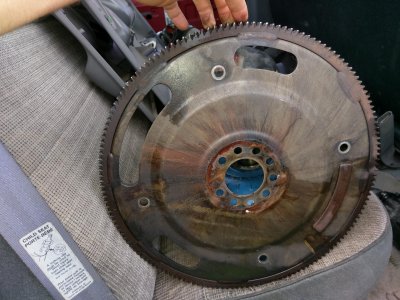

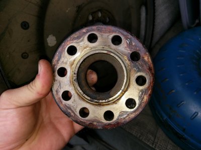

Here is the flexplate and space i removed yesterday from the IDI Turbo parts truck. Are all flex plates missing that bolt hole? Is it missing on the crank too? I didnt even notice when i pulled it off. So do i need a special flywheel and pressure plate when i upgrade my stock clutch since my engine is a factory turbo too?
If you are converting from Auto to Std trams yes new bolts for flywheel new TURBO specific flywheel and clutch assembly as the balance is quite different from the non turbo engine.
Please make sure your engine is indeed a turbo if you can by posting seriol no. It is just left as looking from flywheel side of block or on drivers side of IP tower stamped in the block.
Once confirmed factory turbo then parts decisions can become reality
Shawn, look the second picture in your post. At about 4 o'clock, you will see a weight about 5" long, welded to the flex plate. This flex plate came off of a 7.3 IDIT (turbo) engine. The non-turbo flex plate does not have that weight.
Hope this helps, JL
