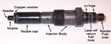

I have thought about the tolerances as well........With a little bevel on the bottom of each injector hole it should keep from ruining injectors orings unless they are WAY different. And We might not be thinking on the same page with the threaded holes. My thoughts are to have the cups that cover each injector milled smooth on the inside. Then a hole drilled from end to end through the bar for fuel to flow between the cups. The ends of the lengthwise hole would be the only ones threaded to allow the attachment of fuel hose going to the pump and filter and so forth.

Here is a VERY crude cutaway drawing of what I was thinking. It's almost as good as cad......I think............Let me know if you can see the attachment.

I think some of you guys are trying to give ADV a Migrain Headache,:dunno trying to make a one piece manifold. It would take a special length drill, about 18" long by 3/16" diameter. Look at an injector, there is very little room for error (drill leading off). If IIRC, the squeeze on an O'ring is 0.0010 to seal. My thoughts for a good seal, is to use a good lube like Vasoline, not only on the rings, but inside of the cap also and Viton O'rings and a good twist of the cap when pushing down to seat. The top O'ring is very close to the top end of the injector, any fuel/air leak would come from there.
Edit: In case you don't know, you have to install the top o-ring, then roll the bottom o-ring over it.

Manifold could be made by making caps and welding good sized tubes between them and putting a fitting on the ends for the rubber lines...just take a junk head junk injectors and add caps and weld in tubes...now installing said manifold over 8 Orings that's an entirely different proposition LOL
Kind of like a fuel rail on a EFI truck/car with multi port injection.

If you look at the factory caps It doesn't matter where the return line contacts the injector cup. There is a sealing surface at each Oring and a small channel between them for fuel to get to the hose fittings. So that really isn't the critical measurement. Your biggest tolerance problem would not really be the injectors themselves but the position of the injectors in the head. And I'm not worried about giving him a headache lol If he can make the one piece cups this should not even be work by comparison.
