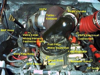

I've heard of people having trans problems with bad ebp sensors/clogged tube.
That's a new one on me. Never heard of that. I don't even know what a EPC sensor is.
I know what a EBPS is and a EBPV is, but they have nothing to do with the transmission. You can completely disconnect them and the transmission will shift just fine. Those two controls basically just make the engine heat up quicker.

Pleased heed what we are trying to tell you. On this forum we, the members, probably know more about these engines and transmissions than most mechanics. We do everything possible to protect people from inscrutable mechanics, not condemning your mechanic, but things just don't add up. Not knowing what code(s) were pulled, it's difficult to diagnose your problem. Ford has there own trouble codes and it takes a special code reader like I have listed or equivalent. " AutoEnginuity with Ford Enhanced".
Most mechanic's don't know you have to hold the throttle to the floor with the key on and engine off when pulling the codes, otherwise you get all kinds of codes that are not relevant.
