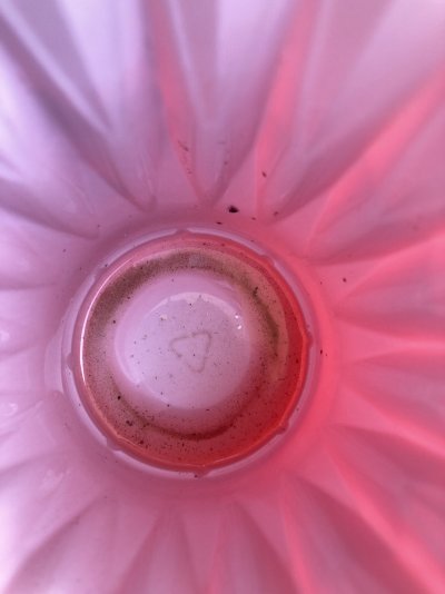

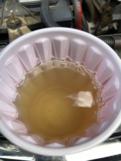

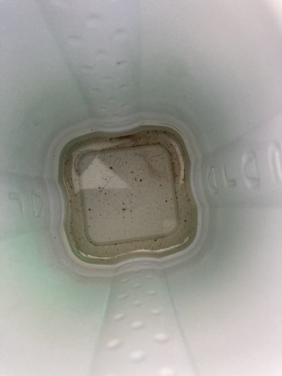

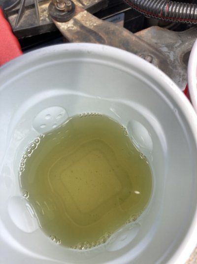

This is what came out of the fuel filter. It only has 700 miles since I replaced it. Seems like an excessive amount of junk in there for such little miles. I filled with diesel kleen ran for 20 seconds and I’m going to let it sit for an hour.
