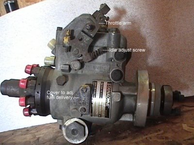

How are you getting the rpm? The stock tach is not reliable, especially at low rpms. I've seen many that read 300-500 rpm at idle and then are accurate over about 800 rpm.
Also, IIRC, idle speed is set internally in the pump. The stop screw on the pump lever is not supposed to be an idle adjust, it's the lower stop for the arm travel. Remember that the throttle arm doesn't directly control fuel injected, rather is loads a spring that connects to the fuel controls along with the governor.
338
The internal idle screw is to take up any slack in the idle spring at assembly. The external idle (stop) screw is used to set the idle RPM. If you still have the label on a valve cover it will indicate what the idle RPM should be set at, usually at 650 RPM.

So I just went out and turned that screw to the right and got my idle set at 650. Seems to have a touchier gas pedal now and it seems to have fixed my low oil pressure gauge!! Oil pressure used to drop off the table at idle but now it sits right in the middle of L and H. :)
