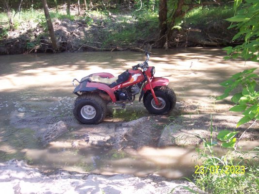

While I had no idea that they were offered in automotive applications, I am extremely familiar with semi auto (or auto clutch) transmissions and their usage.
