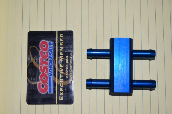

If you're worried about running the transmission too cool you can have a temp sensor in the line. It will cut off flow to the cooler and return the fluid to the transmission until the fluid temp hits a certain point. That will eliminate the possibility of running the transmission at a temp below it's optimum operating point.
I'm running a Long Tru-Cool Max, model LPD 4739, with a GVW rating of 40000. It came with the inline sensor I mentioned. Picture below. The Costco card is there for size.
