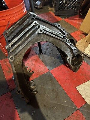

Just compared the two, the powerstroke adapter is thicker. If you were closer I'd give you one of the many I have laying around for an idi if that's the one you need. Don't have a spare for a powerstroke, but plenty of spares for an idi.
