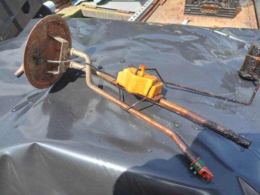

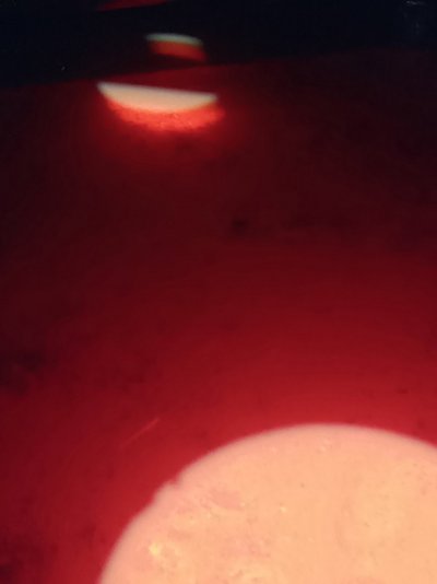

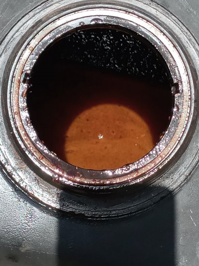

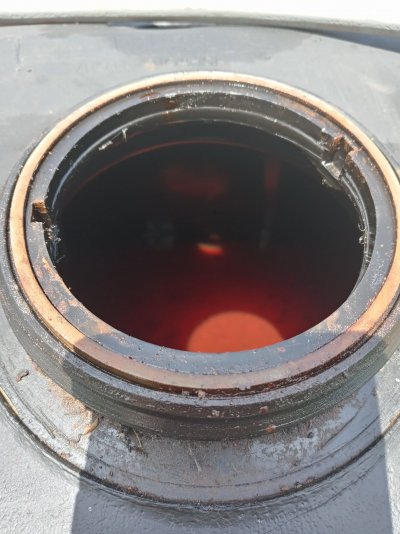

Well this originally started a while back when I had less of an idea of what I was doing than I do right now. It would run out of fuel at 1/4 tank. Then Hurricane Harvey hit and I pulled the tank only to have it sit there for a while. I got around yesterday to working on my rear tank to get my truck back on the road. I pulled off about 10 gallons of dark diesel. During the sunlight today I tried to take some pics to show you what it looks like in there.
There's about another inch or so of clean-ish diesel on top. The rest below looks like water and black tar. Not sure how to dispose of that material or how to properly clean the tank without a visit from the authorities. My guess is that it's almost 3 gallons of "crud".
I was thinking maybe get some of the dried mulch on my property and just do a small camp fire deal to burn it off.
It definitely looks like someone has been in here before.
I got a new shower head for that pickup but after looking at it some more it should probably be replaced. Any ideas?

Just poured it out and there's a HUGE difference between what I expected it to be (stuff in bottom of tank) and what it actually was (5 gallon bucket)
I got one of them new water powered IDIs.

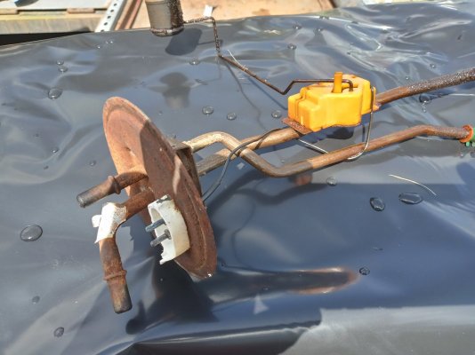

Found what's left of the old shower head. It didn't just fall off. It became one with the sludge.

This black tar sludge resembles molasses, in summer at the north pole. I'd tried cutting with diesel clean, gasoline, oxyclean and dawn+water. It just stays stuck there. Is there a trick to getting this out of the tank and off the pickup assembly? Thanks
12,447
11,189
At this point, you may be better off to replace the tank and the entire sender. You may spend a chunk of change and a lot of time cleaning only to put the tank back and have issues because of what you couldn't clean out/off.

About 10 year back I bought a fuel tank out of a 85 Mercedes 300D from a forum member on another forum. Those thank sit in the trunk, and are long, tall and narrow.
About 1/2 way up the sides it looked like some sort of crap like chicken skin.
I dumped in about 2 qts of Lacquer thinner, laid it one side for a while then the other. Sloched it back and forth and then dumped it out. Added another 2 qts and did the same thing, but used a rag tied to a stick to scrub what I could reach. Even had what looked like deposits of tar in spots. I got it all cleaned out and rinsed it a few time with gas.
Put the tank in a 82 240D and still driving it today.
So unless you are going to replace the tank with a new on, give it a try.

Update: The lacquer thinner seems to be working very well in the tank. I will order a new sending unit and get that tank back online. Thank you both very much!

Do either of you know if the 7.3L shower head will fit the IDI sending unit as a proper replacement part? I ordered the 7.3PS by mistake.

Not sure. But I know the 6.0 shower head is the one i used when shoving my f26e tank in. Works great for past 3 years or so.
