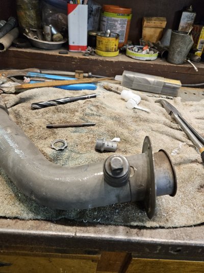

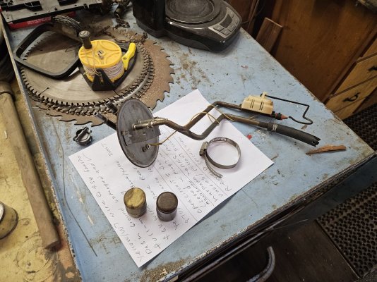

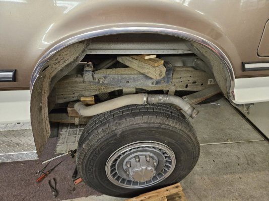

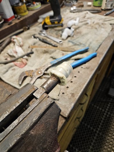

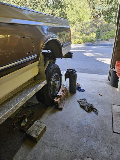

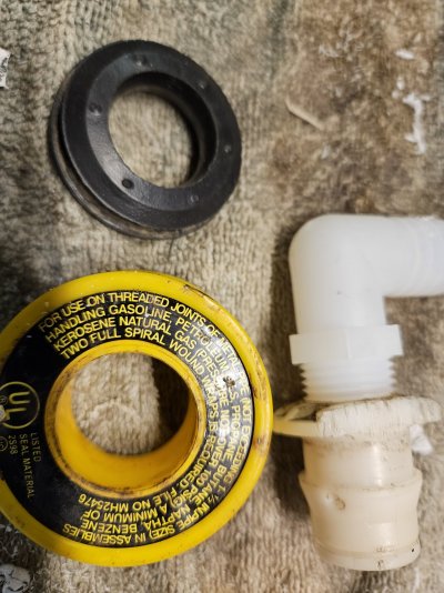

In the meantime search
Harpooning the tank
tank vent
tank vent hose mod
filler vent
Rollover valve
Brb
Well seesh guess i failed to bookmark them.
Basically you are removing the 1"+ air vent hose from the filler tube and running an exterior vent to the filler neck using the tank vent port.
While yer in ther do the showerheads.

My way ain't necessarily the best way, there's 3-4 threads here showing you how to get it done...

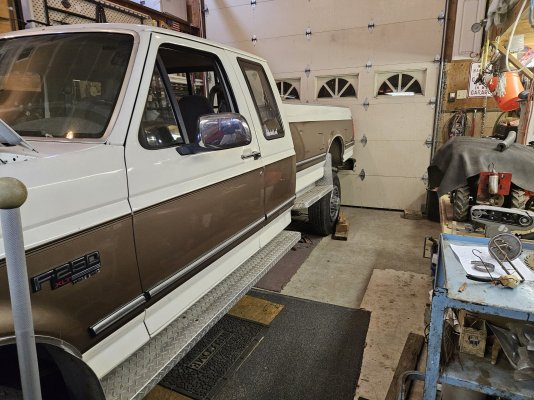

I’m not sure you guys are getting the full picture. It will only accept the equivalent of an old guy labor peeing when the prostate is acting up lol. Ive also noticed on the front tank that same issue of needing to do half throttle and depth/angle adjustment to stop it from popping the handle.
