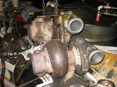

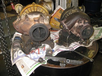

"How difficult could it be?", I said. All the parts interchange right? Well, yes...but... I knew about the difference between the single shot and the split shot injectors, and the electric fuel pump vs mechanical. Let just say I've learned a lot lately. I've done my homework, and let me share my learnings. Along with a 7.3 2nd gen update, the combo is being changed from auto to manual transmission.
Lets start with the differences, or what I changed.
Intake Manifolds
Gen 1 has the smaller 2.5" small holes. Gen 2 has the 3" holes.
Turbo
The 1st gen turbo is a Garrett TP38. 2nd gen is a Garrett GTP38. They do not interchange. They mount differently to the pedestal. 1st Gen mounts by 4 bolts from the bottom of the pedestal. Gen 2 has two at the top. A real improvement, especially for servicing. Anyone that has removed or installed a TP38 in vehicle, will appreciate this.
Pedestal
The pedestal is a different height. The bolt pattern is the same, but the Gen 2 mounting flange is thicker, and the mounting bolts are longer.
Up pipes
The Gen 2 up pipes are longer because of the extra pedestal height.
Accumulator
A visual comparison

I would go with the "gen 2" turbo setup. Throw some bellowed up pipes in there also. Dorman makes a great kit actually.
