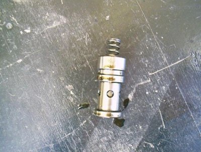

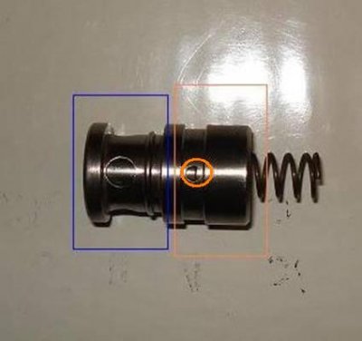

The power stroke oil coolers are very similar aren't they? I wonder if the springs and valve would interchange? Doesn't anyone have pics of one being rebuilt?

I have an idi cooler out of a truck I can pull regulator and measure if need be. Heres some pics I found. Looks similar maybe? The 6.0l glow plug harness fits this engine maybe something else will too haha

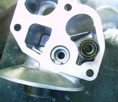

Idi appears to be much shorter though maybe the spring could inter change?
