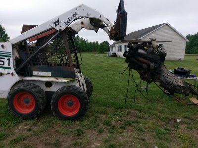

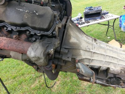

I pulled the motor on my parts truck to have it rebuilt so it's ready to swap in my truck. Took me about 4 hours from start to finish with getting the radiator core out so i can resuse it on my truck. It's a 94 IDI factory turbo, has 168k on it i'm having my machinist dissasseble it and look it all over then rebuilt it with studs, a cam either from Russ or Justin, the 910 springs (where can i get these from?) Justins intake, and the 200SX turbo from Justin. Anyway is there anything special i should have done while its out? Any brand of head gaskets to avoid or bearings? I have read that the factory oil pump is better than the aftermarket ones, with 168K am i better off just reusing the stock one? If lifters are OK i was going to reuse them as well as pushrods. i'll be resealing the oil cooler and doing all the bolt on stuff when i get the engine back. I dropped of my rebuilt heads with the engine too so he could choose between the two.

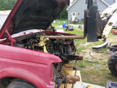

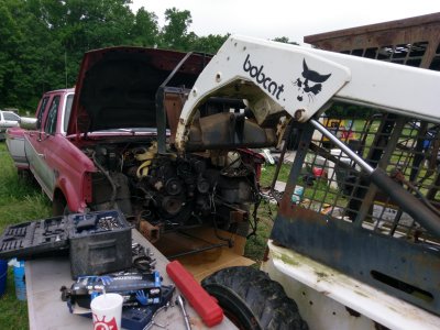

The engine was fun to get out, i could not for the life of me get the auto trans to separate so i just used brute, well Bobcat, force. It's amazing how strong that shift linkage cable is :) drug the truck about a foot trying to get it to come forward. Through all that and lifting the entire engine out it was held entirely by the two locating tabs and when i set it down i pulled it apart with one hand go figure. I had a jack and wood under it and all and couldnt get it to seprate.

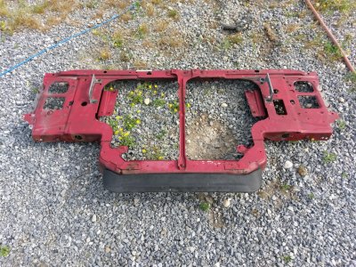

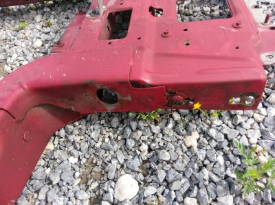

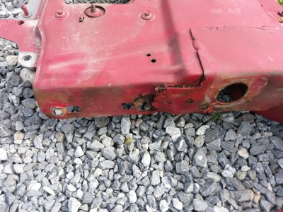

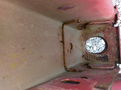

I also pulled the radiator core because its in good condition, mine is missing the entire passender side mount from what looks like a battery leak. Should i weld in any additonal support to the mounting area? I plan on using some good rustoleum paint, i'm not sure i want to POR15 it, i've heard mixed things with it. The rustoleum protective enaml has stuck to everything i've put it on so i will probably stick with that.

I've had a few dozen engines and transmissions out and apart, i couldnt get it to budge. No flatblade, no pry bar, no pipe against anything, no jacking up, no lowering it down, it was fused. I actually thought there was a bolt i missed until i saw it partially separated after i got it out
