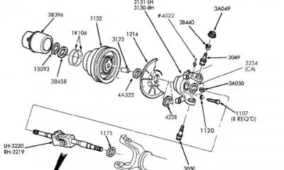

Are you talking about the axle shaft u-joint or the driveshaft u-joint?
edit: Nevermind I reread it. And see your talking about the axle shaft joint. If there is play in the shaft side to side you have had to of broken a snap-ring. Look at the illustration I attached in the next post because I can't figure out how to attach when editing ...top left see 3B396 aka hub lockout then going to the right there is a 1B093 aka snap-ring. The axle will move probably 3/4-1" side to side without that snap-ring.

Anyway here is the picture
And I might be a little on the strong side at 3/4-1" more like 1/2-3/4"
