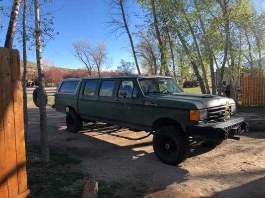

built one into my bumper

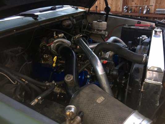

You have a tough ask to put a front hitch on and keep an intercooler as everything will be completing for space. I built a front hitch on my old IDI with a flip up license plate bracket (remember filling up the old GM cars with the gas cap wedged in to keep the license plate out of the way?). If I had it to do all over again, and I was only going to use it for bikes and other lightweight stuff, I think I'd just pull the bumper off, flip it over and build a bracket that fit inside of the bumper with a receiver tube that goes where the license plate is. If you don't like a flip up bracket, mount your front license plate on a hitch plug and just take it off when you need your bikes. You could also consider putting more than one receiver in front as sometimes it's handy to have a second mount, say for your license plate when you have your bikes on board and you need to comply with the Oregon front plate policy.
