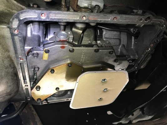

My c6 has the 4th gear added. Haha yeah I bet y’all were like 75 mph!?!? I wasn’t thinking about that earlier when we were talking about the differential gear ratio. First one I’ve had with the OD unit. Does anybody know how that shift point is adjusted? Everything else shifts at around 2k with nice easy gradual acceleration. The 4th needs 2.5k to shift at all though and it just doesn’t seem right. It feels like they may be adjusted separately??
Contact GearVendors and order the instruction manual. It has gear oil that needs to be changed every so often. It looks like it already has a deep sump, which is good. It's computer controlled so i don't think you can change the shift points on it.
