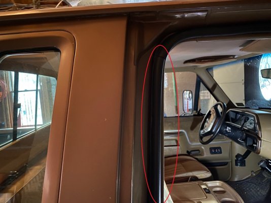

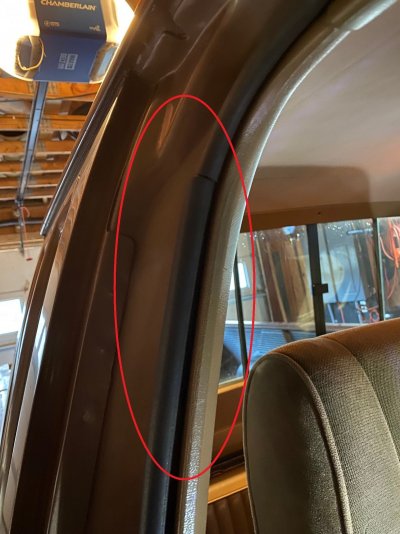

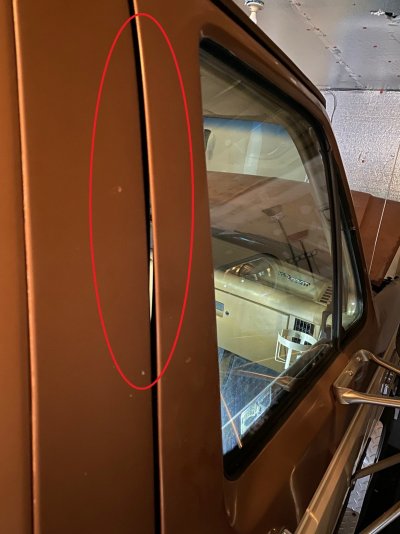

Here you go.
The gap where you can see light through is about 8" long but you need to move the camera to see all of it. The gap starts just below where I cut the slit to insert the 5/8" stuffing down through. And the gap really didn't get any smaller after stuffing the seal. That's why I'm thinking that new ones won't be any better.
The door seems to meet the seal above and below this area and the old seal wear seems to confirm this.
The door works perfectly and looks perfect when closed and there's no sag in the hinges throughout it's swing motion. It just has this damned gap that I have no idea how to close.

I'm no expert but looks to me like the door isn't shutting tightly enough. Should be flush with the panel behind it instead of protruding out a bit. Could just be the angle of the picture tho...
Brian VT
Oct 25, 2021
974
559
Maine, USA
Yes. That's just the angle of the picture while trying to show the light shining through this gap.
The door mates perfectly with the cab exterior when closed.

Looks like you need to either replace your door striker or loosen it and move it in, tighten & check clearance. Will move about 3/16" to 1/4" which will pull the lock side of the door into the body. Probably have to adjust it a few times for ideal closure.
I've had to do this too my '86 a few times over the years after replacing the gasket/seal.
