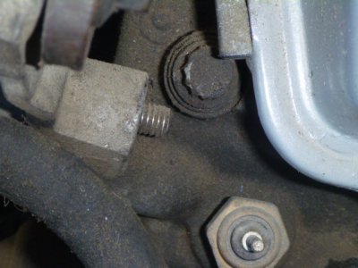

Doesn't help to much, you removed what I was trying to figure out. Lol can't figure out how the ps bracket and the Ac bracket mesh together
see the two open bolt holes? one in the front right above the alu ps bracket and the one in the rear where you can sneak in a nut behind the plate? see below pic.

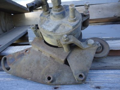

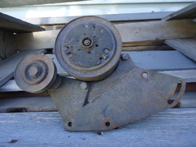

Yes I will be using it for oba. Still looking for a good pic of the front mounting with the large ps mount plate
TahoeTom
May 19, 2010
749
113
S. Lake Tahoe, CA
Here is what I have: was dealer installed. The compressor is not what you have.
