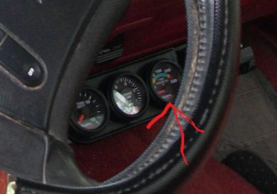

How are your oil pressures with this setup and where are you taking the oil pressure? I am seeing my oil pressure drop when the oil heats up and was thinking about this. I can see 4psi hot and 26psi cruising at 2000 rpm even with 15w40
wow! those are low readings.im reading,i dunno like 45/50 i guess on cold start (im pretty sure?) and then (i'll have to watch it again to know for sure) like 35/40 hot.i dunno if i see below 25 mark at all even at hot idle.
i just recall your supposed to see approx 7 psi minimum per 1k rpm? does that sound right? my pressures are always really high (both trucks) so as long as i always see the needle up over 25 psi,i always know im looking good.
you might want to pull over after pulling a grade and shoot the pan.when i saw 260F outside the pan,i figured a oil temp sender if located there would of probably showed 265+.
you might be really surprised just how hot your oil is running.
im running Mobil 1 turbo diesel truck 5/40 (9k oil change intervals. 12 quarts with aux cooler and lines and m1-601 jumbo sized filter)
handy little buggers;
http://www.amazon.com/HDE-Non-Contact-Infrared-Temperature-Thermometer/dp/B002YE3FS4
i installed a oil temp gauge in chip truck too but never did install a sending unit.i should just install it somewhere if im not going to get around to having a bung welded to my pan......though i know my oil is always cool (above and around 200F) with the aux cooler.it's still a waste of my gauge just sitting there being dumb.

I carry a two dot ir with me for work so I will check next time. My coolant never goes over 200f. I am using an electric gauge and I'm wondering if it's just a funky sender because I never see a low pressure oil light or the factory gauge read outside of normal. Both my sensors are in the turbo block too. I'm not too worried about it. I checked my oil pressure regulator when I changed my oil and it moved and oring closed fine as best as I could tell. I see 40psi on cold start and usually 30 to 32psi cruising hot at 60mph. I'll have to try a mechanical gauge temporarily in place of the factory sender and see what it reads.
