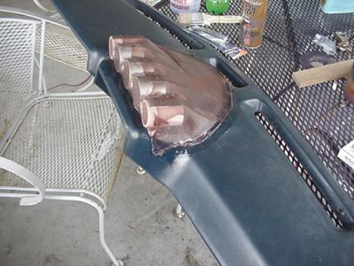

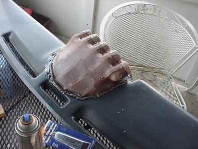

as in gauge holders? i went out this morning to get some pics of my wts light setup and my speaker area on top of the dash had fallen down. what a great time for another projectcookoo. so i made a new gauge holder. how does it look?

Please tell me that you kept that OEM 80-86 dash clean of resin:eek:
Looks good though, if you could make that into a mold, I think this is a much better idea than a pillar mount pod. I could make something out of aluminum sheet, but it would never have the flowing curves that composite allows.

I love the design. However, unless that's bad lighting, it looks like you have air pockets in between the three pods on the left when pointing up. If you leave it like that ,it will be very brittle and it will eventually crack.

thanks guys, my first attempt at "glass", went better then i thought it would. still need to let cure, sand, apply another layer, blend, and paint.;Sweet
i saw those, that was the first layer, i don't know why it did that? open area under them at that spot?
I like the design. What size guages does it fit?
there odd ball size gauges, bigger then auto meter 2 1/16 smaller then there 2.5 (they came with my air system), the two on the ends are for my arb's front and rear, middle three are front- left and right(dual needle), tank pressure, rear- left and right(dual needle)
Basically yes. It looks like you tried to lay up too much resin at once. you need to have everything with a supporting base right under it for the glass to lay up against or you wind up with an air pocket like that. Since you alredy have the pocket and the hard resin underneath, you can build it up carefully now by puncturing each of the pockets and filling them in with a few progressive layers of resin till you top it off and get a smooth finish that you can sand off clean.

I have been kicking around the idea of doing something very similar lately. I was thinking something along the lines of removable from the dash to make wiring access a little easier. Yours appears attached or is it just sitting there for display purposes?I am impressed with how nicely the actual guage cups look almost looks like it was done using a mold of sorts. I installed guages yesterday but used a cheesy shucks mount till I build something myself. Please keep the pics coming I am truly impressed and would love to see the finished product.
apparently you don't know how mad my skills are or how bad my ocd kicks in on projects like this:rotflmao:rotflmao
permanent mount. the gauge cups are a combo of pvc pipe and a metal fixture that fit my odd ball size gauges. standard autometer gauges fit perfectly in, i believe, 2" pvc pipes. don't quote me on it though.
pic time, second skin applied and cured. air pockets cut out. first application of body filler in anticipation of final skin
