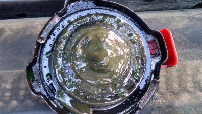

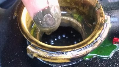

Here are pictures of the goop in the radiator. Of course the 3 idi in a row

looks like an oil cooler pull is in your future along with a good flushing and coolant filter or two wouldn't hurt things much either.

I found the hard line going from the radiator to the transmission to be spraying onto my oil pan, also the T-case is leaking , Even gets better the pan leaks in the corner due to a stripped screw.. It was snugged but had a little drip from that one bolt so gave it a little more of a turn and it just spun. Thinking of taking the E40D from the crew cab and put in the 94 and making the crew into a manual. Think hauling my camper a manual would be better?? Got to sleep on it for a while but for now the 94 is on the back burner.

In post number 7 has picture whats in my radiator. I keep loosing transmission fluid not evidence of it dripping on the ground. I repaired the hard lines to the transmission. Is it possible it's leaking into my radiator due to a bad radiator? Truck doesn't run hot I haven't gotten over 200 degrees yet according to water temp gauge.
