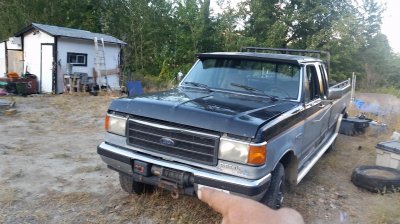

Oh...my...
91 f250 now mine
attachment.php
OW MORE PICS COMING..BUT.....
Time to decide auto or 5sp truck....ugh.....
Flipping a 60 in takes a weekend...hmmm....
Thinking outloud

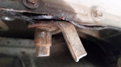

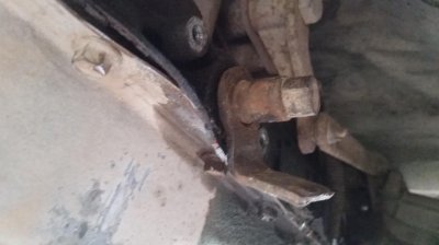

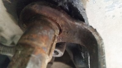

Removed front twizller from diff...left what was left on tcase buwa ha ha
Removed NSS from trans..after bending the shifter down and out of way.
Thus here is what I found :eek: so far....
attachment.php
attachment.php
attachment.php
And kinds local Ford stealerships image.
attachment.php

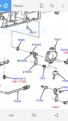

Based on what I see...and speaking to Ernie at West Coast Transmission...that actuator is a single piece you remove from INSIDE the trans after pan removal...
Thanks for looking.

you'll be able to fix that,no problem.worse part of it all will be the atf shower,dropping the pan.:D

The hardest part of that repair is pulling the roll pin out of the tranny case.
Change the manual lever seal while its apart.

Any tips on roll pin pulling?
Got seal and pan and shifter arm...lookikg pretty good for rest of parts for shift linkage too...thus once all parts in hand one can begine the task of re n re shift arm linkage pan a d a rear driveshaft
More to come once parts in hand....
Once truck running Son and I can decide keep or sell...he coughed up doh for it...his call but we can make a good bit if we sell and thats kewl. Start buying and fixing and selling a few rigs make some cash together.
I use good sharp flush cutting pliers. Grab the end of the pin, give it a gentle twist and pull it out. Ford has a special tool for removing the pin. Trying to find that tool is harder than pulling the pin.LOL
When you install the pin, drive it just below the pan rail. Do not drive it all the way in.

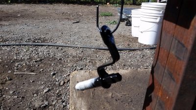

Ok so shift arm and pan from west coast trans came in...looks like incorrect pan compared to mine...no biggy seeing as @ifrythings shipped a pan and linkage. It will be that pan I use and now to see if the linkage is correct. Hoping so...

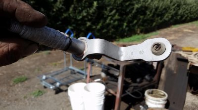

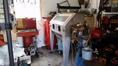

So with that I got the blast cabinet into my shop...
attachment.php
The first real job was the shift arm.....I must say...finally found a use for teflon tape....so I thought :rotflmao...wrapped the shaft w teflon tape and blasted the arm...
attachment.php
Clearly that teflon tape was useless against the blast media...:rotflmao ...ahhh...no biggy lets see how it is for masking...
attachment.php
So there it is in all the glory..blasted painted and now in truck ready to take down and get installed next week.
Sure hope this isnt too bad a job...
BTW this was the first time in a very long time I dug out my teflon tape....a d about the only thing it would get used for too.
Thanks for looking

Electrical tape works wonders for sandblasting, do 3 or so coats of electrical tape and don't hold the blaster on it and you'll be good.
Mite want to look into changing that bushing on the shifter linkage so it doesn't fall out, Dorman makes one 74043 which can be hard to find or 14057 but only one in that kit is useful for you.
