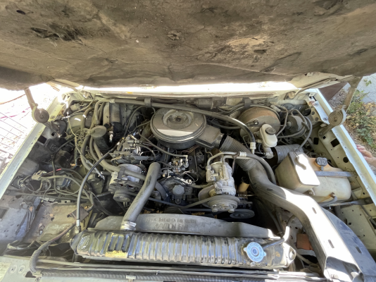

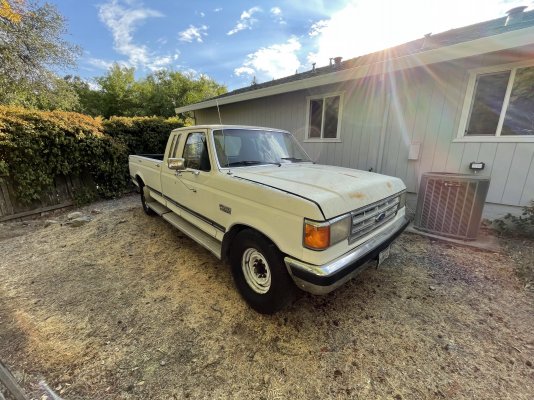

1989 F250 C6 Automatic 2wd 3.55 diff Extended Cab Long Bed in need of lots of TLC
The frame was swapped to a f-super/f550 at some point in its life. It was then abused way beyond legal GVWR and a new transmission was installed (said the PO). Not long after (between 500 and 1500) miles the engine failed. (due to excessive ether)
I put batteries in it and tinkered for a bit. Wouldn't start, and the flywheel teeth are worn from long cranks by the previous owner. Ether was used commonly, even in the summer "for quicker starts". (& quicker death!) The motor held on for 7 years of this treatment.
When I got it it almost started and then the flywheel teeth chipped because the motor locked up. Couldn't even turn it over with the gp's removed by hand or with the starter. The starter now grinds and doesn't grab enough teeth to turn the motor over.
Gonna have to pull the motor.
