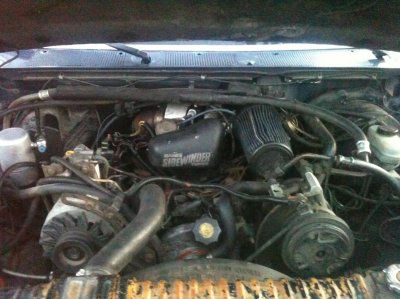

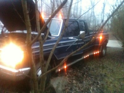

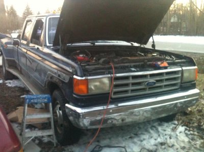

its nothing specil i bought it to haul my car to the track and not really care if it gets a dent or what not.. paid 1900 for it..
