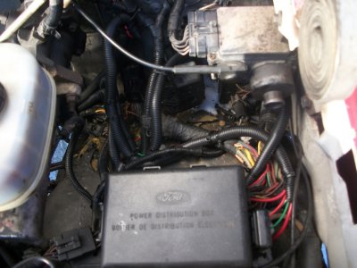

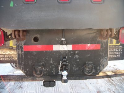

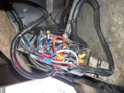

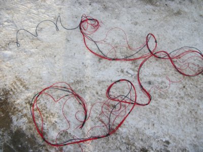

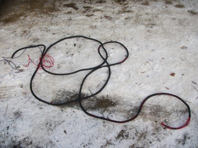

the electrical work continues......
so had to move equipment around and ready chip truck for plow duty for the storm coming in,but i did manage to ready log truck with a tow harness so she'll have the tow package like any sensible person with an f450 would automatically make sure it included from ford lol.
didn't have time to snap pics,but i did run it as well.though no time left to hook any of it up.that's ok though,as this was the majority of the work.now i'll have everything on devoted trailer circuits so it's as easy as wiring them on to the dead ended wires and connecting to the new tow plug out back.

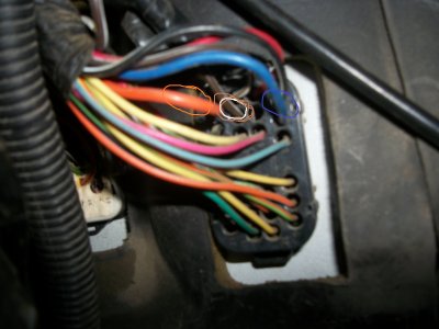

i do still need to find the two wires (green and a yellow) which are on devoted fuses up in the power distribution box.each on a 5 amp fuse.i'll double check to see if pulling the fuses kills the stop/turn signals out back on the truck.it shouldn't as it says they're for trailer.then if thats the case,it's just a matter of finding those,and tapping them onto my two 14 awg wires i ran.if they do however kill the trucks stop/turn then this means,i needlessly ran devoted 14 awg wires and could have just tapped in at the rear junction.
BLUE = brake 10awg.
ORANGE = 12V+ (key on/run) for battery charge.10 awg.
BROWN/WHITE = running lights.10 awg.
BLACK = ground (this is already run) 10 awg.
RED/YELLOW = backup lights.missing.no where to be found.easy fix however.i'll tap into the trucks backup lights (which is black/pink) at the tow plug/firewall side,and have this trigger a fused relay that i'll install and feed the backup of the tow plug on a devoted 10 awg i ran for it.
YELLOW = left stop/turn
GREEN = right stop/turn
edit;
see the yellow and green wires at the very bottom of the in cab plug?
notice the blank pins on the firewall side?
i think i just found the stop/turns right there.i'll test 'em tomorrow.

You don't mess around with wire sizes! ;Sweet
I understand the heavy wire for the brakes and the battery charge but thats some serious wire for the lights.
When I redo mine, I would like to run the bundle of wires all the way back and put the connections under the hood like you are doing as well. It just makes good sense to me. Yeah, its more wire and yeah the drivers side frame rail is already a little cramped with brake lines and fuel lines and the wire harnes but I think it's worth while. I'm also eyeballing that back-up camera.... I see possiblities for that with those of us who don't always have someone around to help hitch up.

yeah with such a long truck i didn't wanna mess around.this way here i can always tap into some aux work lights at the rear of the bed too without worry.the backup lights was due to the long run on the truck and i didn't bother to check out what the dual aux lights on the dump trailer are,and look into amp draw etc.just easier to run 10 with that too and not worry about it.didn't want any regrets latter on and pulling,re-running larger wires for future add-on lights and stuff.the stop/turns was an easy choice to just run 14awg as there wont be any need to tap into those for anything serious.
yes,the backup cam right up over the hitches sure helps to hook up.big time saver when alone.

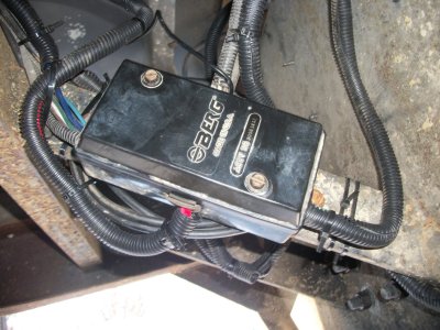

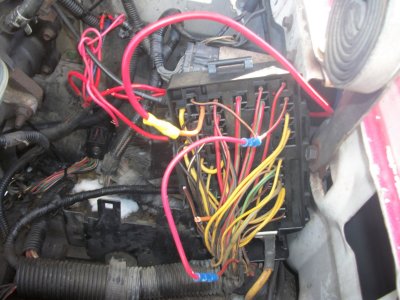

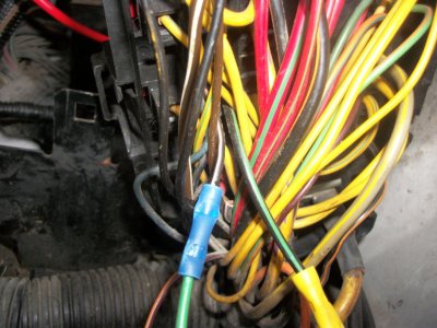

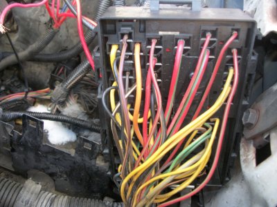

ok so tonight on log truck..... getting the backup tow setup all updated now with the modern multi plug,updated hitch and balls,rear view cam.
however,that orange wire is a fake.not only is it a slightly lighter gauge than the one on the f250 w/tow package,but she's not hot with key on either.so the 30 amp trailer battery charge circuit has nothing hooked up to it,and i think a dud 12 awg wire may be capped off on each plug.
so looks like a devoted key on/run relay setup will be required here along with a relay triggered for the backup trailer circuit.no problems with doing either of those.
unfortunately those bottom green & yellow wires are not trailer turn signals off the two devoted trailer stop/turn signal fuses either.not sure this ones worth messing with.likely will just wire in the trailers stop/turns in with the trucks out back,unless someone knows where to find the lines from those two fuses coming out of the box.
real close now.it's amazing how much longer doing this kind of stuff takes when it's so damn cold out.ugg.i hate it.need a 40' heated shop!

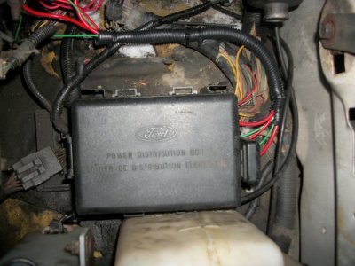

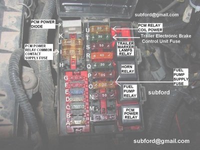

ok,so you know what i'll do here then.rather than run devoted fuse holders and relays and who knows what with the trailer stop/turn signals.is to just wire up the power distribution box.big power line is already right there,the fuses are there for everything i need,going unused and there are unused relay ports as well.so i'll simply unbolt this sucker and wire it up for for fused relays right in it and this way too,i can see about those devoted fused stop/turn circuits to feed my dual 14 awgs i run for them.
i'll do this "right" and take detailed pics for everyone to copy who also don't have tow package.
so the blue brake line,and the brown/white fused/relayed trailer running lights are fully hooked up.so no need to mess with those.simply snip those off inside the cab side,and butt connect the new lines run to them and done for those two.for the rest i'll tie 'em in to the blank spots in the box tomorrow and post detailed pics,to make this easy to follow.

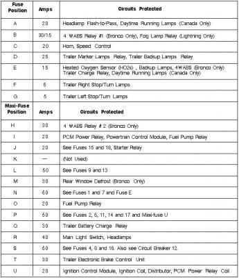

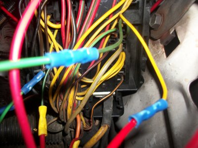

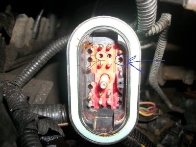

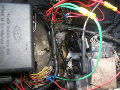

tonight on log truck......the electrical fun continues as i draw near to having a complete tow package install.
ok after taking a half hour to pile on layer upon layer of cloths,so i could hardly move, it was time to finish this mess up.so i pulled the PDB (power distribution box) up and out and flipped the old gal over to access her working side so i could alter it and make use of it for my tow package.
so for our idi trucks,we have no use for the fused and relay circuits labeled in my '93 users manual as " fog lights (lighting only)" relay #1 (upper top right) nor the "fuel pump" relay #4 (4th relay down)
so these are perfect to rob and make use of for;
ORANGE = 12V+ battery charge when key on run.
RED/YELLOW (though not run at all.known as PURPLE at the tow plug end) = backup lights.
so starting with the top circuit.this ones super easy and perfect to use.FUSE Q as noted here in the pic and it's known as fuse #18 in the users manual.this is the 30 amp "trailer charge" fuse and it powers the upper relay! yes.how perfect!
so snip off the dead ended orange wire as low as possible so as to crimp on a butt connector here and hook up the devoted line you ran out to the tow plugs red wire,to this wire.
the yellow wire is feed.it is feed trough the 30 amp fuse as noted above.the black wire is the ground.the last wire,the brown one as you can see is the trigger.cut it.we need a new trigger.a power line when the key is in the run position (or if you prefer,a switched power source of your own to turn on the connection whenever you want.i strongly suggest the same power source however,or at least a power source,only with key turned in run to run up to your toggle.this way you leave the toggle on,the key still turns it off for you.)
now also snip the dead ended brown wire with stripe (i think its just another lighter shade of brown.i forget and the pic is unclear.but it's clearly the last line to this relay,directly above the black one.)
i fed this one a power when in key run,that feeds fuse K and known as #11 in the '93's users manual.apparently unused.i did however leave power going to it,as you can see,and just tied in.
that's all there is to this one.the other ends of the wires you just cut are dead ended someplace.who knows where.somewhere under the steering column i suppose.go ahead and cap them off for extra safe measure though.battery charge for dump trailers battery......complete.on to the next one.
you may not need to worry about this one,but it sure will be nice to have a hd backup light system,especially for such a long truck that will have a backup alarm,dual aux backup lights (and i see two angled ones down under the truck they had on the reg system to help shine up the sides of the truck.-i like that idea! i'll change out the bulbs or replace these lights) along with dual aux backup lights on my dump trailer.so to me,this was well worth running another relayed 10 awg line for.here's how i rigged this one in,making use of the "fuel pump" relay.2nd relay up from bottom.
snip off the dead (on idi trucks only!do this to a gas truck,and you'll be going nowhere fast lol.) large black with green stripe wire and tie onto your devoted wire run out to your center pin wire of the 7 prong tow plug.purple.
so again,you need a new trigger.this ones just as obvious.you want this line to power up when you place the shift lever in R.so just tap into the backup light line that's used for backup lights of your truck.this ones a black with pink stripe on my '93.keep it connected to the rear and just run a line up from it also,for your new relay trigger.hook it onto the black with white stripe wire it looks like as shown in the pic.
so what fuse is this relay on you may be asking? well conveniently the one labeled in the owners manual as "trailer backup and running lamps" the 25 amp fuse in D position according to the above pic,and known as fuse #4 in the manual.yeah.perfect yet again.
now just make a note in your owners manual of the new relays.run a line through them indicating they no longer represent those and write in the new labels "trailer battery charge" and "trailer backup" and your done.
lastly,i then wanted to make sure if my trailers stop/turn signals short out,that they blow those two devoted fuses as shown above and leave the trucks stop/turns in working order.
F and G (he shows dual 10 amps.they are supposed to be 5 amps each fyi.) they are fuse numbers #6 and #7 in the owners manual and it calls them "trailer LH stop/turn lamp for the upper #7
and "trailer RH stop/turn lamp for the lower #6
im not sure yet how to make sure these work as this is where i ran out of time.
first,i didn't mark my 14# awg wires,so i'll have to ohm them out and mark them up at the firewall so i know left and right.no biggie.then it may be just a matter of hooking them up accordingly to the two lines i extended out for them off the yellow and green lines as shown.
i saw the green and yellow wires dead ended down at the firewall side as stated before.so i figured id just tap in up here where it's easier and leave those lines dead ended to nowhere in the cab.anyone know is this is right? i'll temp hook 'em in and hook up to something and then see if iv got brake lights and blinkers i guess,then if so,remove a trailer stop/turn fuse to see if kills them but the trucks should still work.this should work like this best i can tell.if so,im done.crimp,wire loom,tie and call this tow package complete.if not,it's back to the books to see what iv got to do lol.getting close to full tow package now boys!;Sweet

tonight on log truck.......enough of this electrical wiring.im seeing cross eyed and color codes in my sleep!
so today i finished up with everything.i had forgotten i had already tested those green and yellow wires for blinkers earlier on.so no wonder i still didn't have stop/turns when i hooked up the chipper to test.
so this means those wires from the multi switch (left and right stop/turns) which are orange w/blue stripe and green w/orange stripe only go out to the rear of the truck on the non tow package setup,and wherever they get tied together (up in the column some place i guess) with the tow package,they are dead ended.ran,but not hooked to go out to the PDB on non tow package trucks.so rather than dig into the PDB again to grab these wires,i easily found them entering the box and sniped them right there.simply tie into (but leave connected) the wires going out back to the truck lights and hook them to the PDB yourself.this way they will pulse your meter through the fuse and you'll know you've got it with the blinkers on.then just test the new wires running out back for left and right and crimp when right.pull the fuses and only the trucks will still flash.if she shorts,out goes that trailers stop/turn on that side only.isolating the issue while maintaining the other side and keeping the trucks lights issue free for max safety and correct tow package hook up.finished up with one last wire loom run w/ties and its all she wrote.who would of thought an f450 would leave the assembly plant without the tow harness.i still can't get over it,but she's got it now.

yes.this is right.testing the connector without the switch connected.
well this is interesting.i wouldn't have thought the difference between those voltages would have been the reason for the glowing light.i did think it was odd both would be powered at once though,but since i don't know how it works i didn't think much of that.the 10th of a volt on the tan one had be scratching my head thinking poor ground or something.
so the pcm isn't switching internally then, to power/ground the correct lines to the switch.but it's operating correctly.just glowing and kinda flickering at me making me nervous that it'll soon get worse and leave me stranded while working the truck.
white - light green at od connector switch comes from pin#32 at pcm.
tan - white at od connector switch comes from #41 at pcm.
the red - yellow isn't in the diagram and i dunno where it comes from.
im fairly sure the 12V and 14V was listed correctly.in case it matters, though i could have stated the wrong wire was lower/higher than the other.
for example when i said the red/yellow read 14V it could have been the white/lg was the 14V and the red/yellow was the 12V.
if it matters any,let me know and i'll verify.i didn't pay full attention cus that 10th volt on the tan/white grabbed me by the horns i guess.:D
