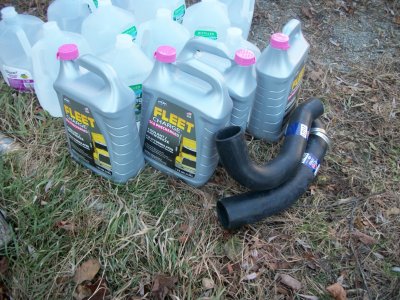

well not a whole lot done to her today,but i did give her a coolant flush with upper and lower hoses.
hey,you know when you buy a lower hose,you have to transfer over your old spring? well the one i bought at carquest had the spring in it.thought that was good.forget what the brand name was,but i see their made in usa.another odd bonus these days.anyway,now she's sporting fresh fleetcharge w/ sca and i don't have to worry about being left beside the road with a blown hose while hauling some wood.;Sweet

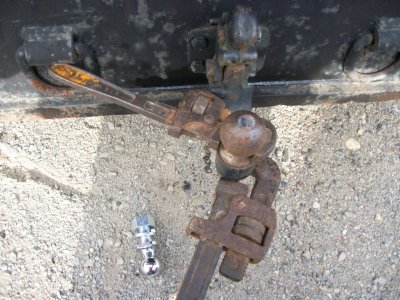

so i went to swap out the 2 5/16 tow ball for the same 2" curt ball (all my stuff uses a 2'') i put on chip truck but,the dang shank is too small for it on log truck....come on man lol.so i'll need a different 2" ball with a skinnier shank.kinda too bad cus the curt 2" has a nice 10k lb rating.ah well.

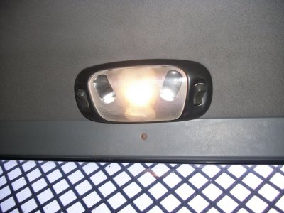

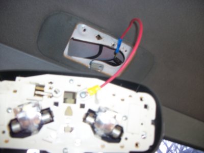

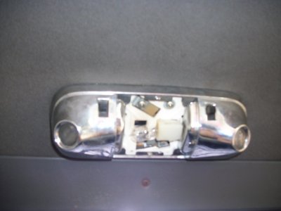

so i looked at my to do list for something to fill in some time before the ball game,and it arrived via e-bay.the updated interior light from later 90's cars and trucks.i got to cheat too,i had to get out the meter and figure out what it took do to,to convert it over to make the light and map lights work (though they don't point correctly anyway) in chip truck,so i simply dropped it down to see what i did and just copied.
this is one of those upgrades you do to the truck and wish you did way sooner cus you can't see crap with those worthless yellowed lens old school 80's left over pieces lol.so now when i open the door at night,the cab is actually lit up bright,clear and white.;Sweet

my bad,i meant the new replacement ball is the one that has the larger shank so it wont fit the smaller hole in the receiver (odd i know.i didn't expect that.)

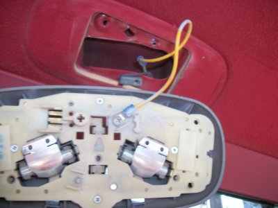

just search ebay for ford interior dome lights.this one here was used in pickups,mustangs,taurus etc.in the mid /late 90's range.
to install; pull the fuse for interior dome light.
simply remove the green wires wire clip and discard.next do as posted in the pic,wire on a short section of wire,and crimp on a spade type terminal under a short screw that fits as shown.
next place the light up where it goes (as shown in the installed pic.notice the map lights face upwards,not downwards) and screw in the two original long screws into the remaining open holes which are directly in line with each other.
as you'll notice the original lower screw will go right back into the black wires wire clip,and the other will now just screw into metal.
reinstall your 15a fuse again,and wala.she's on when you open the door nice and bright.like 5x what you had and white instead of tinted yellow lol! plus you have some silly aimed map lights that'll always work too with door open or closed.
very,very easy job.10 mins tops.you'll wish you did it way back on the first day you bought the truck.
oh yeah,you'll see there's a short screw where you need to place the long one.that'll go into the now upper blank spot (where the clip was originally,that you pulled out clipped off and tossed) this is the screw you remove not only for the that,but to place on the new wire spade or ring shown.almost forgot how i did it haha.should make sense when your doing it.likely sounds confusing right now,but thats cus our not looking at whats being done.
so with this,you'll be able to see what i mean when you do it.
the bulb style for these particular dome lights are 578

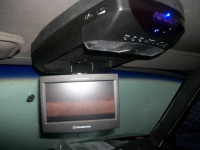

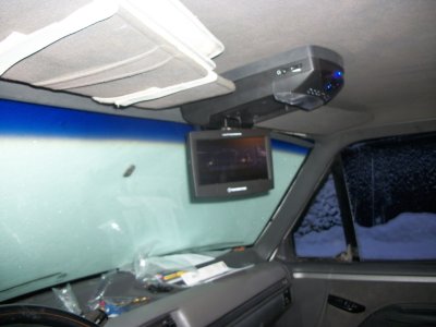

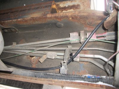

tonight on log truck..........log truck turns movie theater!:D and rear view cam.

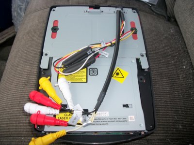

PIPEVISION Overhead Monitor w/DVD #VFDD-T701 & BOYO #VTK-350 Rear-View Night Vision Camera w/Shielded 35' RCA Coaxial Cable.Wired For Full Time Rear View Use.
well it was cold out this morning and i really didn't want to be out there lol so i sat around in here sipping coffee and checking out the pintle hitch setups for my plan of attack.the excitement got the best of me though when the man in brown showed up with the rest of the goods to install my back up cam,so i bundled up with 6 or 7 layers and headed out lol.a few pics are in the dark,cus i just came in.
here is an exact replica of what i did to my f250,though with a much longer run of rca cable.;)

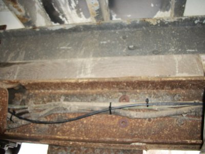

so i installed the overhead cam,and since i now had grounds and switched power right up in the pillar for the gauges,there was little wiring work.the major of the wiring was running the hd shielded rca cable waaaaaaaay out to the rear.run her up and wire tied to keep it all up nice and of course inward of everything so that should a zip tie fail,the stuff still can't fall to the ground and get ripped out.

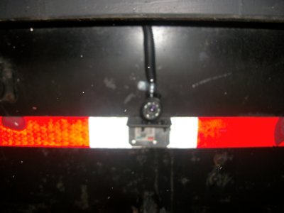

i then mounted the cam above the hitch and can keep an eye on behind me when backing up,and of course it's great because i wire the thing on,not with reverse but switched power,so i can see behind me as if it's a rear view mirror.real handy when towing to keep an eye on the trailers.brings great piece of mind.
though i don't have time for such things as watching dvd's while im working haha,these units are just affordable as the combo,for around a hundred bucks or so,for the monitor,cable,and cam combined.a small price to pay to be able to see,and of course it could save a life someday too.
so tomorrow,i just need to connect the cables to the cam.i had to run out for some heat shrink.so with that,i'll shrink the rca connections.one rca plug goes to cam for pic of course and another for power/ground.i'll tap into the rear junction box right there to see if i can find switched power (let me think here,the battery charge wire i guess it will be) along with the ground and then that'll be that.

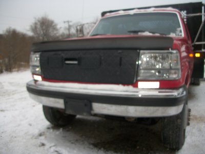

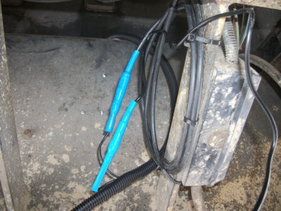

tonight on log truck.....................log truck gets new peepers! finished wiring up the cam,and a new washer fluid motor.
Depo Clear Corner,Bumper & Headlights

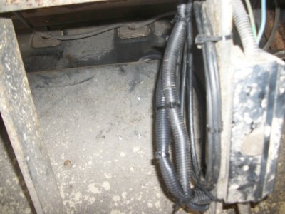

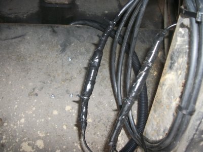

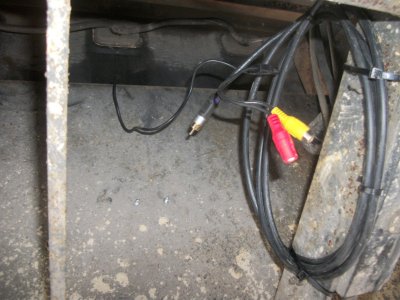

so continuing on with the rear view cam install.dialectic grease.heat shrink the rcs cables.then tapped.then wire tied.then wire loomed and another wire tie event for good measure.
you don't want corrosion in there at all.you don't want to loose power nor do you want your pic getting all fuzzy on ya.

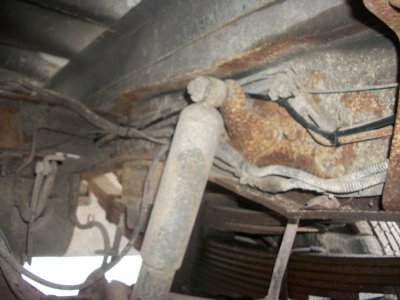

i noticed there are two wires missing out back.the blue wire for brakes (po ran a devoted green wire for it from controller) and also no battery charge wire.
(i just tapped into the running lights in the junction box to test the cam install.) so most likely these got left behind during the frame lengthening years ago.
i'll be upgrading the pintle/ball combo,along with the rear tow plug to the same one i installed in my f250.the updated 7 prong w/4 prong combo.so i'll make sure both these lost wires get run out back from their original location at that time,then switch my cam power over to the correct terminal in the junction.

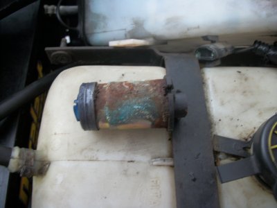

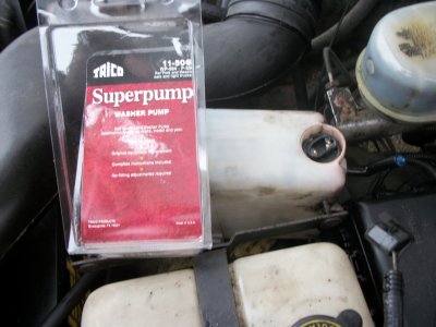

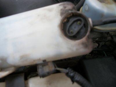

next,i figured id do an easy little repair and toss in a new washer fluid motor as she was toast.now the motor works at least but she's still not spraying,so i'll have to take the cowl off and inspect the hoses next.

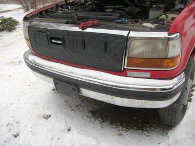

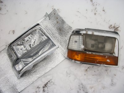

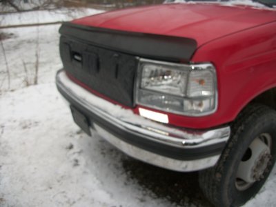

next it was time to copy what i did with the f250 with some new headlights.out with the 20 yr old, dangerously tinted yellow lights and in with some new clear's.i was hoping to install some relays for them but these things always kick my tail and take me time to remove and install.just a hard tight setup.though well worth the effort of course as the beam will be a safe, clear, bright white now.
new chrome bezels as well,as those were showing their age.as was the grill.iv got the old one with the buttons on it for the winter cover from the f250,which is only slightly better shape lol.she'll need to be replaced some time down the road,after she gets painted.
