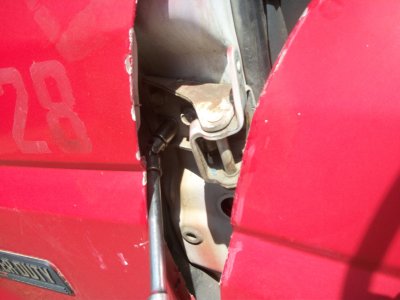

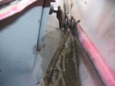

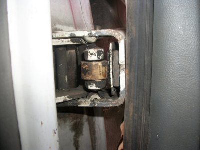

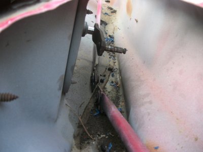

so you may recall where i had tried a new door spring a while back? if not,no loss lol.so anyway i scored a used one.a whole drivers side upper hinge.ironically also white.
so out with the old and in with the new.then it was time to tweak the alignment and door striker.now the door remains open for you when you open it and she closes with nice "click" + "thud" like new sound.

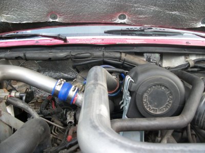

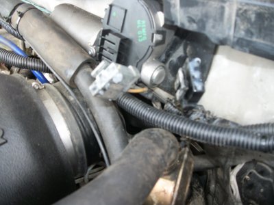

moving forward,you may recall i was working on the windshield wipers? i had replaced the spray motor.well i also scored (from the same used parts truck) the couple t's and line i needed due to mine leaking.i replaced the one coming out of the container and the one up in the cowl close to the driver side wiper along with both spray nozzles.so now iv got a nice working and leak free windshield washer system again.
well while i was in there,fortunately for me i had driven in a small shower to or from work,or it might had been the day out to get fuel.either way i recalled the wiper motor had that real sad sound to it lol.so i figured i might as well get it while the getting was good and be done with the cowl for a while.so i went ahead and put one in from auto zone.same one i bought for chip truck with lifetime warranty.she sounds much more healthy that's for sure.when ever disconnecting electrical wires it's always a good idea to spray them with e-cleaner,let them dry,then hit them with the electric tune up grease.

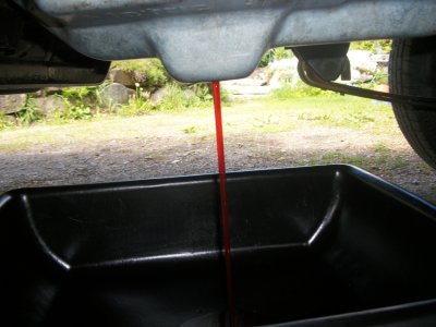

unfortunately my second attempt to cure the front trans leak has failed as well.
now i have a leak from the front just the same,but now it appears to be very minor in comparison.what's more is it also seems to leak only under load.if i pull over and look under,i can see it dripping steady.let idle and it will stop pretty much all together once the converter shield drains.
i had thought perhaps i just overfilled the trans and it was very hard to tell just where it was on the stick.i let some out and then could see it is now a good quart low and it just started to flare into 4th,so can't have that.i can no doubt drive it to the trans shop and let them deal with it.most likely what i'll do at this point.pulling and placing the trans in twice was enough for me.besides i just don't know what would be leaking anyway at this point.
