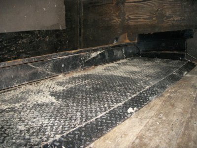

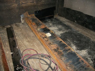

coming soon to log truck......lift gate installation.
just picked up a used lift gate for log truck today.went and got it with chip truck.needs a little rust repair,a new cable on one side apparently,and some fresh paint,but said to be all working.8' wide so she'll fit the bed nicely.oh how nice it'll be to simply roll the big chunks of wood onto the gate and let the gate do the lifting.too many years of grunting heavy wood onto the back of a truck bed.heavy sob! won't mean nothing to log truck though.still all the payload i'll ever need.would be a bit too much for chip carting this sucker on her rear full time though probably.would need a light aluminum one or something.that's alright though.just another reason to take log truck out.whenever there's big wood to lift,she can have the duty too.not just full logs.
i'll have the local welding shop get me a quote to repair the rust (replace the plate of the whole bottom section there) and install it for me soon.;Sweet

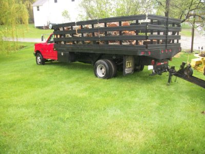

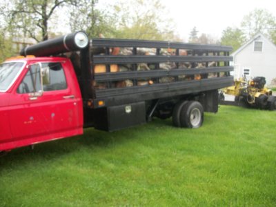

today on log truck............it was logs trucks' first day out! it was this last Wednesday.
so i had a tree removal job right close to the road.perfect for this pavement princes as she could be left sitting road side and haul away both small/mid size trees in one haul off.saving chip truck two hauls (80 miles/2 hours.)
a mid sized black cherry and a small white pine.
it was interesting taking log truck out for a trial run (while i dropped off the lift gate for its repair to be installed soon.)
she made the 40 mile run to the job,but she only made it home 39.5 miles issue free.all temps running great no issues and power to spare!
so much nuts,that if i sped up from my normal 45 mph to just 50 mph pre-hill,this old gal wouldn't even drop out of OD!;Really
half a mile from home however,the OD light began to flash.i figure,ah well.i'll put the code reader on it and see what sensor might be old and in need of replacement (already knowing the trans harness was spotlessly inspected and cleaned) but as i rolled home with a slightly now slipping trans,i smelled the ATF when i opened the door and figured i blew the front seal.sure enough.running right out from the center.this is fairly common to auto trans vehicles when they're left unused/used very,very little like the po had done.
so,it's time to pull a trans and replace a seal,plus replace all the fresh ATF i just put in....but hey i made it home! can't beat that if you have a brake down,in the yard sure is the best place.knock on wood.
but man,a 2nd gen sidewinder,an intercooler,a maxed out ip with 5.13's out back.......this truck didn't care much about the 2+ cord of wood on her back and it had no clue a 1200 lb rayco 1625 super jr stump grinder was even there.;Sweet

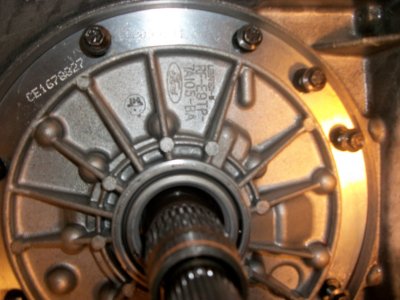

it's lunch break here on channel 444.
down and out.front pump coming out.tail end of trans pointing down or else coast clutch assembly falls out!!!! not an easy task placing the unit as a whole back in.........don't ask me how i know,or i'll lie about it.:D

That little drill hole is to address lube issues in the old days. If you have a hole, it must be plugged. TransGo fixed that in your kit.

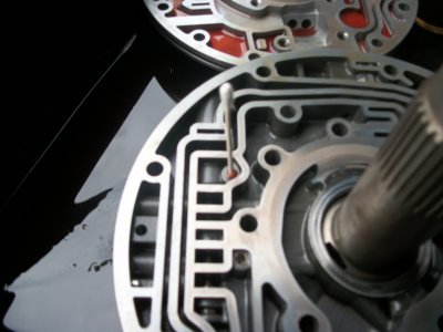

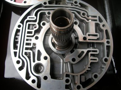

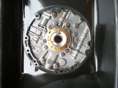

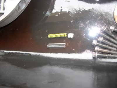

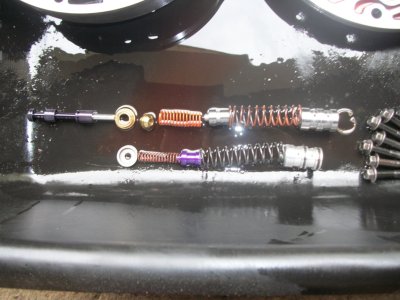

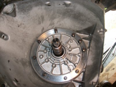

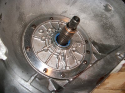

tonight on log truck,it's front trans pump modding and new front seal.
back to page 1 of the transgo instructions;
attachment.php
remove bolts;
attachment.php

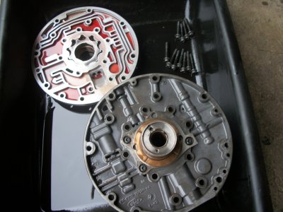

split the pump;
attachment.php
note no hole to plug;
attachment.php

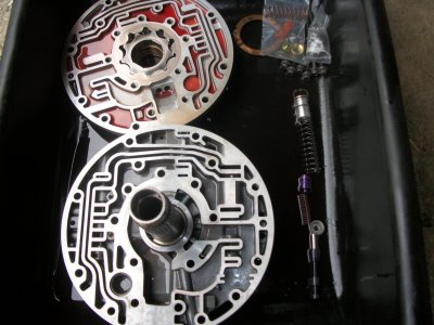

out with the old boost valve and springs (bottom) and in with the new valve and springs etc (top)
attachment.php
new yellow converter regulator spring;
attachment.php

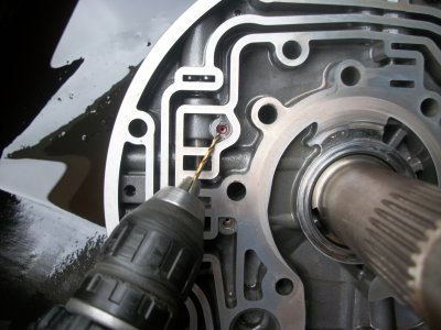

drilled hole out with 3/32 bit;
attachment.php
clean filings;
attachment.php
replaced seal and bolted pump back up;
attachment.php
iv got the old heavy beast bolted back up with the top bolts and lots of misc stuff to go and should be good to go in a couple more hours plus fill time.phew.what a job.
