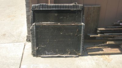

Here's a pic of a 460 radiator sitting in front of the tall/skinny version IDI radiator.......It's a big difference in size.

WOW that Radiator is HUGE!
Oh, never mind it is just the pic that is huge,..
Get a Diesel Radiator, or an aftermarket one. These IDI's have enough cooling issues, no reason to make more of a reason to have them with a Gasser Radiator.

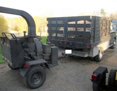

probably depends on your location,and how you use the truck.
if you can keep her below 240 degree's your golden.
oh your in CT.not a whole lot diff than Maine.
i sure have no issues keeping an idi cool.i run the 3 core copper/brass replacement.
i'll be rigging up a partial grill block sometime.all but july/aug seems to need a full open grill.
my e-fans are still not coming on this year yet.but of course it's not even 60 degree avg out yet lol.
i just gross 12-14k (ish) mainly.so nothing too serious compared to some.

""bike-maker
"" I wont quote it because that pic is HUGE! LOL!
Sorry thats not a 460 radiator...This is a 460 radiator
Yes its the same size as a diesel radiator and its 4 cores
This is a 302-351-400 radiator
Big difference...
