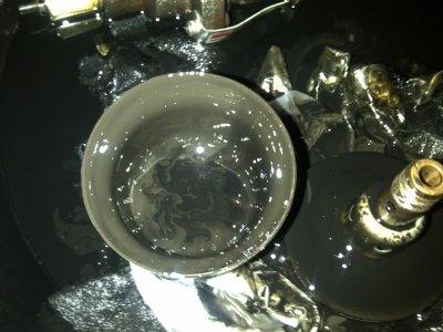

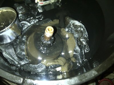

Here's what a fuge does that no filter does Or you can filter for days and go broke clogging up filters. Btw, this oil has already seen a 5 micron filter on it before it got to this stage.

Blind driver. Those photos above potentially represent what your fuel system looks like inside when you run your WMO cocktail.
I think that explains why you need a centrifuge. ;Sweet

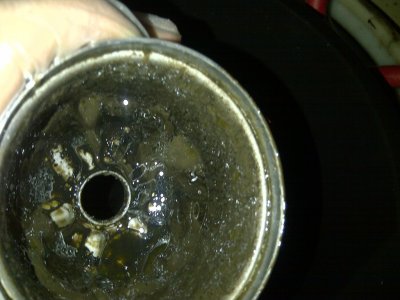

Here's the same oil 1 hour later or 55 gallons later of filtering. This is pass #2. I still got 4-5 oz of contaminants out of this pass. Pass 1 & 2 combined would clog any filter setup I've seen, which at best case scenario adds another $1 per gallon to a 55 gallon batch of fuel. This WMO still has at least 4 passes left until I'd run it in my vehicles.
Like biofarmer said, filter filter filter!
