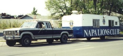

I moved a trailer today from Napa to Redwood City. This is actually an annual thing for me; the local Sea Scouts hold a competition in Redwood City every May, and this trailer's basically a chuckwagon. :) It belongs to some obscure group in Napa; if you take a look at the picture below, you may get a clue as to what the group is. ;)

I'll start out by saying that this trailer is ancient, and as a result isn't exactly safe to begin with. It's got a 2 5/16" hitch, but it's a single axle with no trailer brakes and no WD/antisway setup. Up to this year, my truck's been the only SRW truck that can safely pull it at 50mph. I know that this trailer desperately needs at least a set of trailer brakes and a WD/sway control setup, but it isn't my trailer and I don't get to make decisions that involve modifying it.
Now, for today. First, it was raining off and on, so the roads were fairly slick. I hooked up to the trailer and started moving. I made a left turn out of Napa onto a small highway, and looked in the mirrors to see the trailer fishtailing :shocked: I hadn't taken the turn too quickly, either. I attest that to slick roads, unless someone has another thought.
However, another issue arose. For reasons I'm trying to determine, the trailer was a LOT more unstable this year than it has been in previous years. Instead of being able to safely maintain 50mph, I had to keep the speed down to 35mph to keep the trailer from swaying all over the place. This made for a long and unpleasant trip (a 1 hour trip that wound up taking 2 1/2 hours)...and I'm almost scared to try it again.
Now, for the question...does anyone have any idea what might have made the trailer more unstable? I DID replace the tires in the last year...and the new tires are 255/85R16 tires with a "D" load rating, capable of handling 3000lbs each. The weight rating's comparable to the stock tires that these tires replaced. Other than the tire replacement (and engine stuff, but that shouldn't have changed anything), the truck's stock. The trailer tires looked okay.
So, do I need to go back to stock tires to handle this trailer semi-safely, or was the weather the deciding factor, or what?
