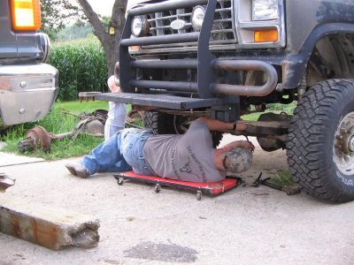

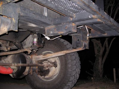

Scott, you can always fab your own:sly
I did on my old '86 F350.
Here's some pics of what mine looked like, and there's some of me and my crew chief working on it from a few years back(2005). Wow Cole sure did grow up fast!
