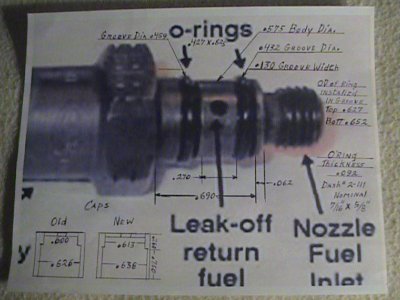

338
So Here is some of the measurements and pic with measurements on injector and o'ring, caps in lower left corner.
I measured six (6) different injectors, 2 were made in Italy, other 4 by Delphi. There wasn't a half thousandth diference between them. tolorances were held close.
All measurements were taken with a Digital Caliper. Some measurements where + 0.0005, I discarded that.
The Old cap, still with Gray paint on it yet from a 1990 IH.
New Cap was made in Germany, with IH part # 180557 I think.
You can see the O'ring groove depths are not alike, the bottom groove Od is .459 and top groove is .432, so actually there is a stretch of the bottom O'ring of .027.
I could lay a ring flat and then try to pick it up with the cap over it, some caps, would some wouldn't, that was out of 4 old would and 4 new wouldn't.
Draw your own conclusions from this. NO, the caps are NOT to scale.LOL Gonna post this over in ADV's thread also.

Lots of good ideas and thank you for the measurements oldbull.
Ok so I am fairly confident in saying that the rail will not work. I had two friends come over and i took measurements on their motors. I had dimension that were .037 out from mine. So what would be the next best thing to do? Caps like ADV? I dont think AN fittings will work on the caps. If the lines that connects the injector are not the same length it will push or pull the cap causing it to leak....suggestions/comments welcome???
