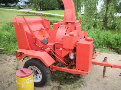

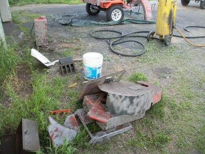

so my diesel wood chipper has seen better days.she was getting rusty,the bed knifes needed to be swapped over,the pump mount broke on me while working and then the (new,several hundred dollar) pump shaft broke and she was finally down for the count.
well after calling to find out a new replacement (with same options) would set me back 24 grand,i looked it over and figured for a couple grand i could fix this one properly once and for all.so i finally did.
first,i took it to the local big truck/welding shop and had them fix the rusted out parts and extend the tongue for me.then i ordered the belts,cables,new hydraulic fluid,sent the new pump i had just bought,out for repair (much cheaper!) and then i had enough of the ugly.it was time to make it look good as well.

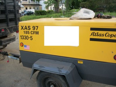

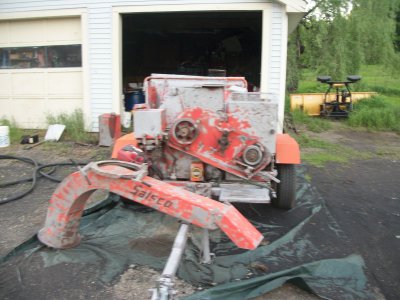

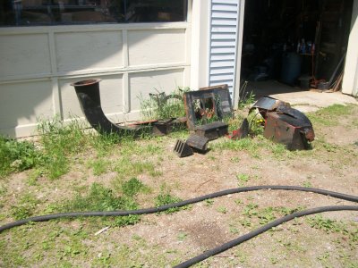

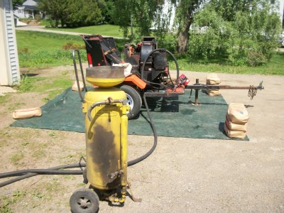

so i went and rented a sand blaster and compressor and took not only the por-15 that didn't hold up very well down,but all the flaky factory orange powder coat down to bare metal,so that all i had was a good clean base to prime.then i decided since the machine was pitted from age of being rusty,why not bed line it right? so i did.i tinted it with a very close match to salsco orange; ford competition orange and put on 3 kits total.now the old chipper not only works as good as new,it looks presentable again too.here's the stages;

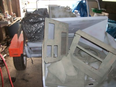

getting her into some etching primer.mostly sprayed using the compressor and gun,but a quart didn't quite do it so i just ran out for a couple etching primer spray bombs (the darker spots) to finish it up.

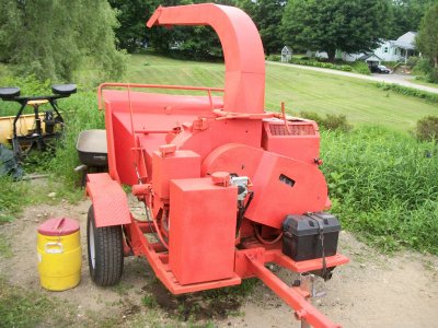

so rather than 24 grand to buy a new chipper,i invested 2,500 into this one (with a perfect running diesel) for all the parts,welding repairs,new fluids,filters,knifes flipped and adjusted,cables,belts,rental,my fuel running for stuff and paint/bed liner kits.she turned out nice! i even ordered a new decal kit that i'll put on latter.iv been using it,so i'll need to wash her up first.anyway,the end result;

thanks.that sand blaster and compressor worked me right to death! worked awesome but holy crap,what a messy job! you'd sure want a enclosed and oxygenated suit/helmet if you did this often.oh man,messy and uncomfortable.you just can't beat removing rust properly though.i bet this holds up for years and years now.
