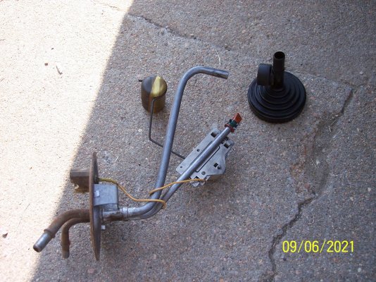

Should the tank end of the return line be submerged in fuel?
Yes but it doesn't go as close to the bottom of the tank as the pick up does. In this picture, this is the sender from the factory rear tank in my Blue Truck. I've pulled the shower head off in this picture, but the return is the one with the orange thing at the end of it.
