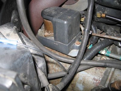

Which ATS turbo?m I have the non wastegated one that sits square to the firewall and the solid state controller sits fine in the factory spot (the ones that sit at an angle have the exhaust side of the housing exposed to the controller so I don't know how that would do ). Have to make sure to use the heat shield that goes under the exhaust side where the return line and glow plug wires go through. I put a some extra fire sleeve on there for good measure and wrapped the exhaust side of the turbo with header wrap. I've got my engine on the stand right now after 5000 miles due to an unrelated item and there was no signs of any heat problems.

From the diagrams I have the ATS systems all leave the controller in the factory position. The Banks system moves it and remounts it on a bracket but the wiring is all long enough. Pic of Banks remount:

I am going to use the solid state unit and leave it stock. It sits farther away from the exhaust then the banks pic. I was tossed up whether to use it or not also because it needed plugs for it. I stocked up on zd1a's when they were on sale, but not zd9's. So I called a local Autozone and they said that were 8 on the shelf. So how much I asked. "Were'er not supposed to have them anymore, so $0.01." What? So I went and got them for $0.09. Went to another store and got 16 more for $0.17. How much are ZD1A's? $10.99!!! I had to have the guys check the shelf for them as the glows were not in the computer anymore. Might be worth a shot for the guys that need the still. Almost got the motor back in the truck except the oil pan was so rusty in would not hold oil anymore. The list just keeps growing.
