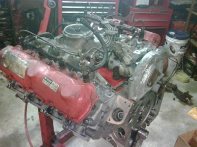

Ten minutes till three eastern time and the shop is just closing for the night;Really Made some good progress on the intake and fuel system after collecting one of my blown engines from my cousin's garage. The timing gear cover on this engine had a lot less pitting and erosion on it. Everyone likes a picture so here it is.;Sweet

looks good! cant wait till its installed! wish i could afford one of these for my f150 LOL
Sweet Goose. Getting closer buddy. Can't wait to see it in the truck......... at the Rally.:D

Man she sure is pretty and clean. I feel like a surgeon needing to scrub in to even touch it.:eek: This is as it came, right off the crate.

As you can see in my center console thread I got a little side tracked tonight:rolleyes: oh well. I did manage to get the timing cover on, water pump and lower radiator hose housing. I carefully got the little stainless ball out of my old engine and installed it along with the t-stat housing. When I realized I forgot the t-stat I decided to call it a night:eek:LOL Yeah, I'm tired:idiot:
674
Goose... Don't feel bad about leaving something out while sealing up the engine... A member here some time back just finished installing his intake manifold and started up the engine. Got it running ok and turned off the engine... Looking at his work bench he sees the fingers that hold the lifter dog bones in place.....:eek::sly That was a moment to remember. When I built my first idi I just got the oil pan on and there sits the nut and washer for the oil pump pickup tube. You know the nut for the main bearing bolt about half way down the main webs.... Yes... that was a messy second time pan installation with all that copper rtv mess on everything. Never did have any leaks in that pan to block seal with the rtv..... P.S. Don't ever use a cork or rubber pan gasket... they will leak on you for sure.... Even the factory never used them. they used rtv... Why a gasket supplier sells something we don't use nor need is way beyond my thoughts.... Other than its a sourse of revenue to them....:dunno
