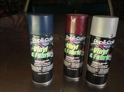

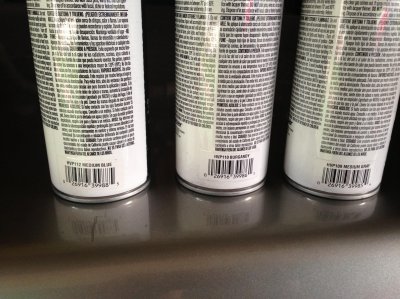

These are the closest you will ever get to matching the factory colors.

Getting the surface cleansed and degreased thoroughly is imperative to allow the product to adhere properly and that's going to determine how long it'll last.
