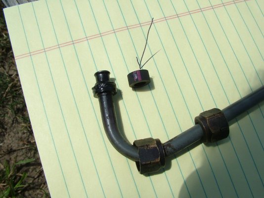

I don't know if using a temporary fuel supply would help because it will idle fine but only drive for a few minutes before it dies. Also, what are "olive" in relation to the fuel system? I have seen that a few places in reading about it but no explanation. I am sure it makes sense once explained and I think i understand the rest of the parts but I am confused on that one.

An olive is the "gasket", so to speak, on the compression fittings on our fuel lines. The olive in the attached picture is on the hard line between the fuel filter and the Injection pump. You can see the old olive still on the hard line, and the new olive waiting to go on as a replacement.

Ah ok, that makes perfect sense now that I see the picture. It looks like my next step is probably to drop the fuel tanks and make sure the pickups are working/clean?
